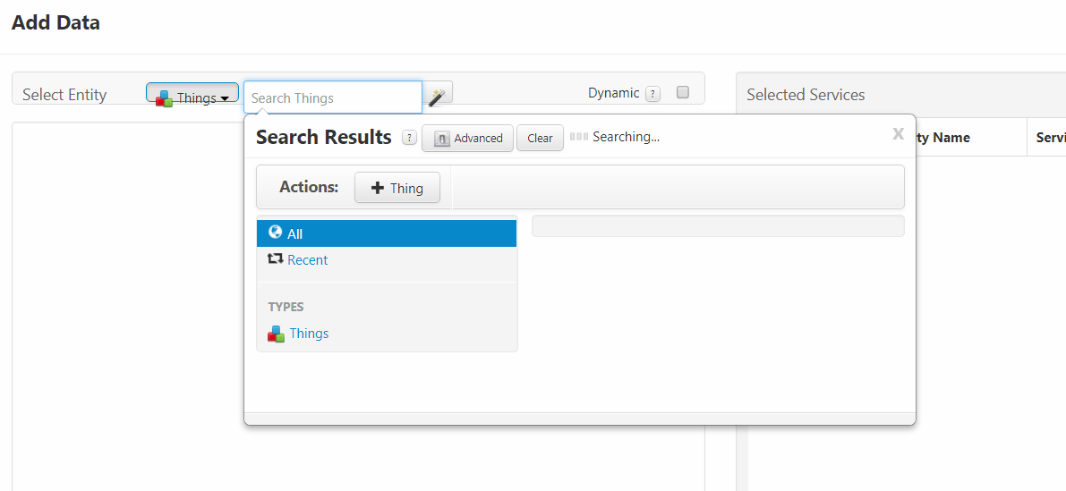

All of sudden, it stopped working and I can't get the services or data from the entities. I am using TWX 8.0 and Chrome browser. Somebody please help!!!!

Hi Avinash, could you please share the Application log from your ThingWorx instance. Are you still able to perform other activities e.g. creating new entities or browsing through composer?
Did you also try on different browser?

Issue resolved internally (over screen share)by cleaning up the corrupted ThingWorx storage and re-deploying the war file.
