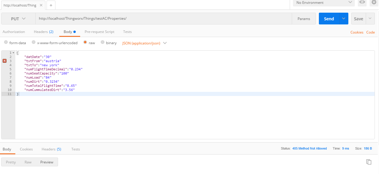

Hey there,
I tried to send one http-put-request which alters the value of multiple properties.
The request looks like following:
But as you can see in the Picture above, this action is not allowed. Maybe I have to reference to the property in the JSON-Body?
Any suggestions?
Thanks in advance,
Theresa
Best answer by AnnaAn
Hi Theresa,
Yes almost the same, but please seperate each property with a comma. For example:
{"Str1":"hello123",
"Str2":"again111"
And again, use this url instead:
http://localhost/Thingworx/Things/testAC/Properties/*

Hi Theresa Lichtenberger​
You could try to request url with :http://localhost:8080/Thingworx/Things/HJ/Properties/*
Hope this helps,
Br,
Anna
May 3, 2017
Hi Anna An​
If I use your request URL, will the body (see in the Picture) still be the same?
Theresa
AnnaAn14-AlexandriteAnswer
May 3, 2017
Hi Theresa,
{"Str1":"hello123",
"Str2":"again111"
