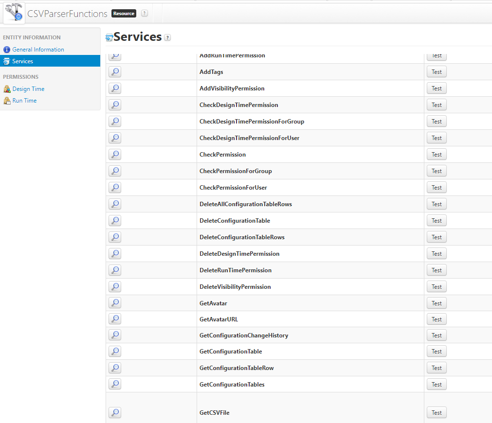

Now, the problem it's clear but CSVParserFunctions it's a resources and I don't now how to grant the correct permission.

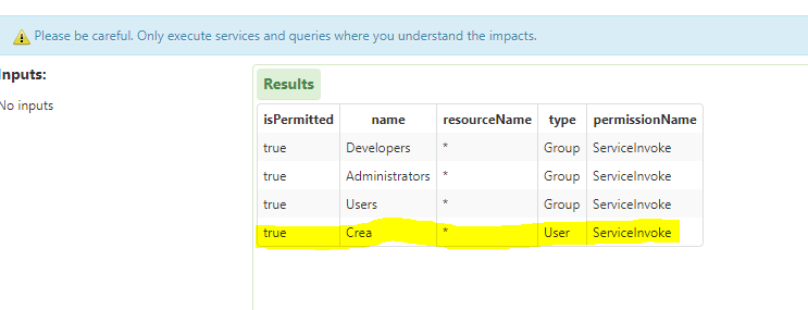

I tried to execute AddRunTimePermission to give ServiceInvoke permission to my user "Crea" and it's been added. but it doesn't work.

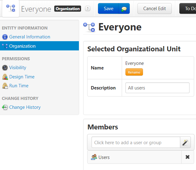

Maybe I found the problem. It depends on the Everyone Organization
We moved from version 7.4 to 8.1 and it seems that in the version 8.1 it's mandatory to add "Users" group to the Organization "Everyone". In the other versione wasn't essential
