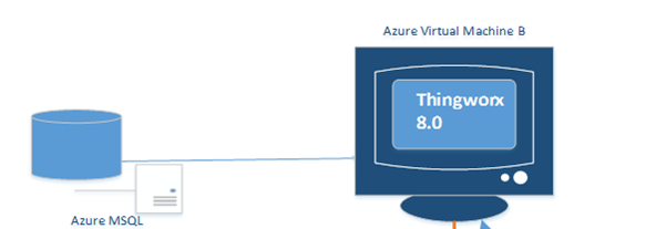

I want to discuss the performance about the configuration below:
  • Azure Sql database : S0 standard 10 DTU
  • Azure Virtual machine: Basic A4 (8 vcpus, 14 GB memory)

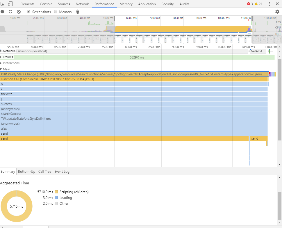

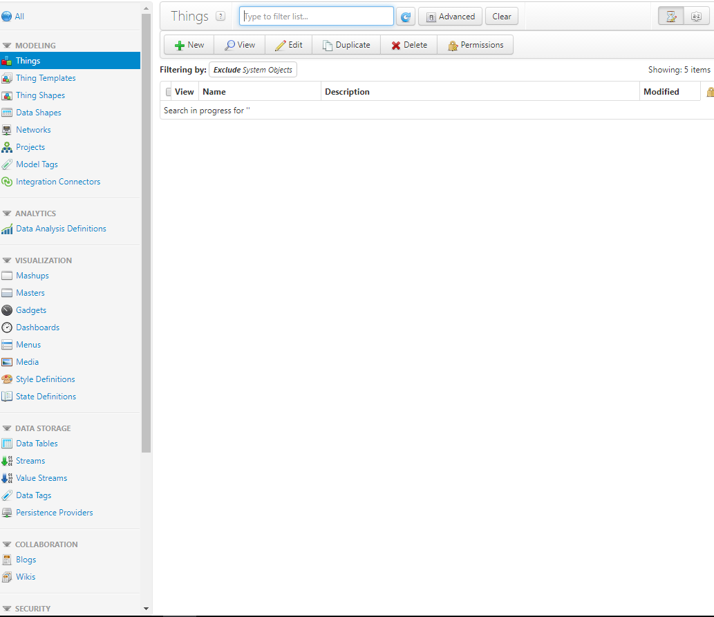

When I click on Things, Thingworx give me back all the things:
the response is very different here is the result:

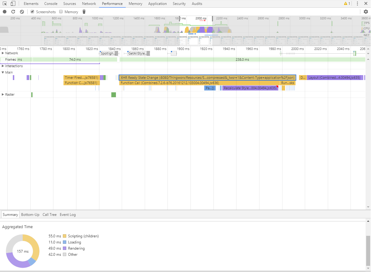

1) Thingworx 8 + Azure Sql   (very slow!!!!)    (5715 ms )
2) Thingworx 8 + Local MSQL  (157 ms !!)
I belive that exist a solution to increase performance ..Do you have any suggestion?

    I found the solution:
    My Azure Virtual machine was in North Europe location
    My Azure Sql DB was in West Europe
    So I moved the azure SQL DB to North Europe and now the performance is great!!!!
