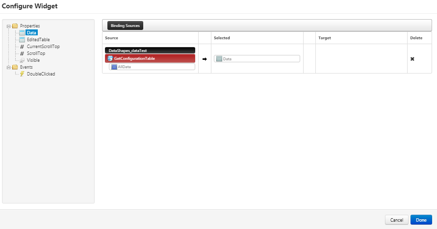

Hi Anselmo,
you should be able to drag the All Data result from your query service onto a grid widget.
You can then configure the grid widget to show the columns of data you are interested in.

Hi Kieron,
The configure part that remains a mistery...
My configure grid colunms has nothing to select and I have no clue of what to do in the page below:
Anselmo.

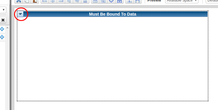

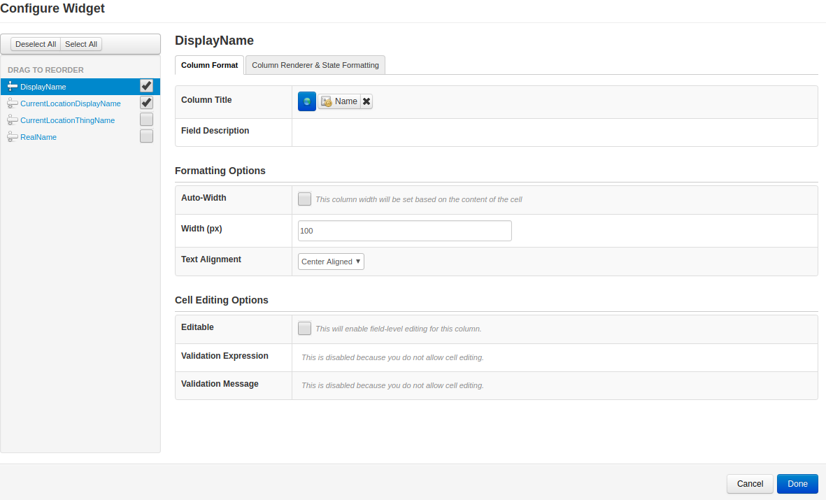

December 29, 2017
on the actual grid widget, in the top left corner is a drop down arrow
Hover over it and one of the options you will see is 'configure Grid Columns'. Select that and you will be presented with a new window which allows you do define the order of the columns (drag to order), and also allows you to configure how the data is rendered, columns are named etc.
