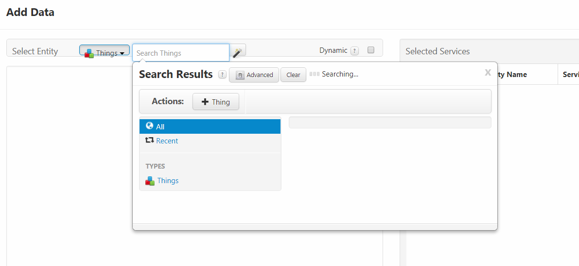

Suddenly it stops working and I can't get the services or data from mine entities. There is a solution for this or a known cause for this is happening?

Could you please confirm us the ThingWorx Version and browser in which you are observing this issue. Do you get this issue every time you use select Entity ?

The version was the 8. And I was in the google Chrome. I have to re-install my thingworx because I was in need to get it working.
The issue has started after I imported an extension and I was also connecting with MySQL database.
I was able to search in the explorer page. But I couldn't surch in the search at the top of the composer page. And also I was not able to search things with the magic wand.
Now I am with the 8.1 version and everything working just fine.

Hello I am also having the same issue now. Any idea how we can solve it without re-installation?
I have created a lot a entities and I cannot afford to re-install.

Check to see if you have run out of disk space.

I was totally not having this issue with disk space.
