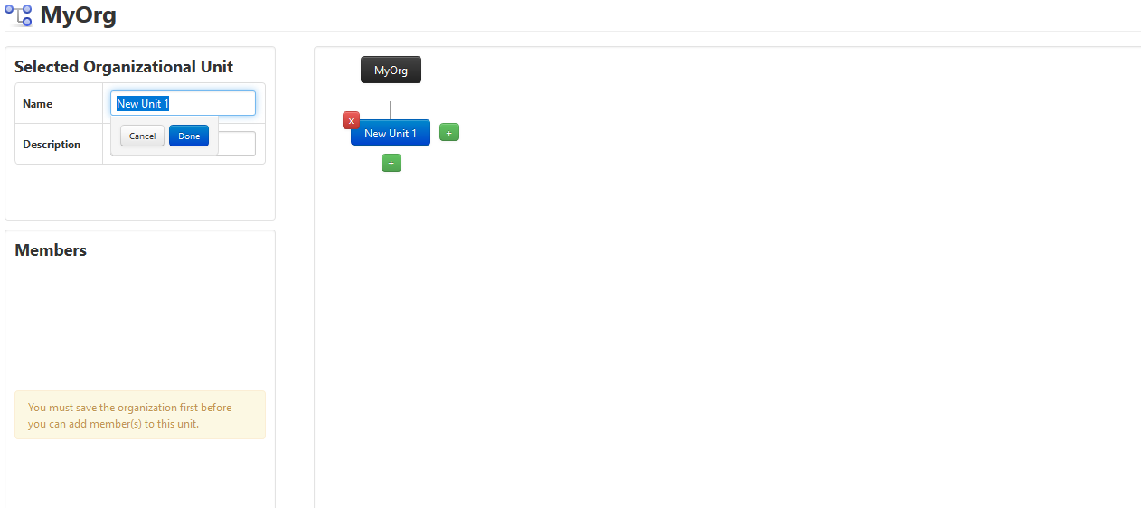

I would like to create a mashup quite similar to the Organization page in the composer
so I have two questions:
1) Is it possible to "take" this composer page and include it into a mashup in order to create new units runtime and have the same graphical?
2) If the answer is No, is it possible to add a widget runtime? So that I can write a service which, on button click, will add another button into the mashup next to or under the one which had been clicked
(My solution to question 2, is to create a lot of buttons and hide them all and, on click, make them visible, but althought it is simple I think it is a quite forced)
Best answer by CarlesColl
No.
Proposed Solution:
  • Use a three widget to represent the Organization Hierarchy
  • Then You just need to create a mashup which will be loaded with the Organization Unit name, and it allow you to create siblings or childs.
October 14, 2016
No.
Proposed Solution:
