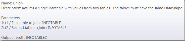

And ThingWorx provide Union option to combine two Infotables into one. I suppose you are looking for this.
var params = {
  t1: undefined /* INFOTABLE */,
  t2: undefined /* INFOTABLE */
// result: INFOTABLE
var result = Resources["InfoTableFunctions"].Union(params);
var params = {
