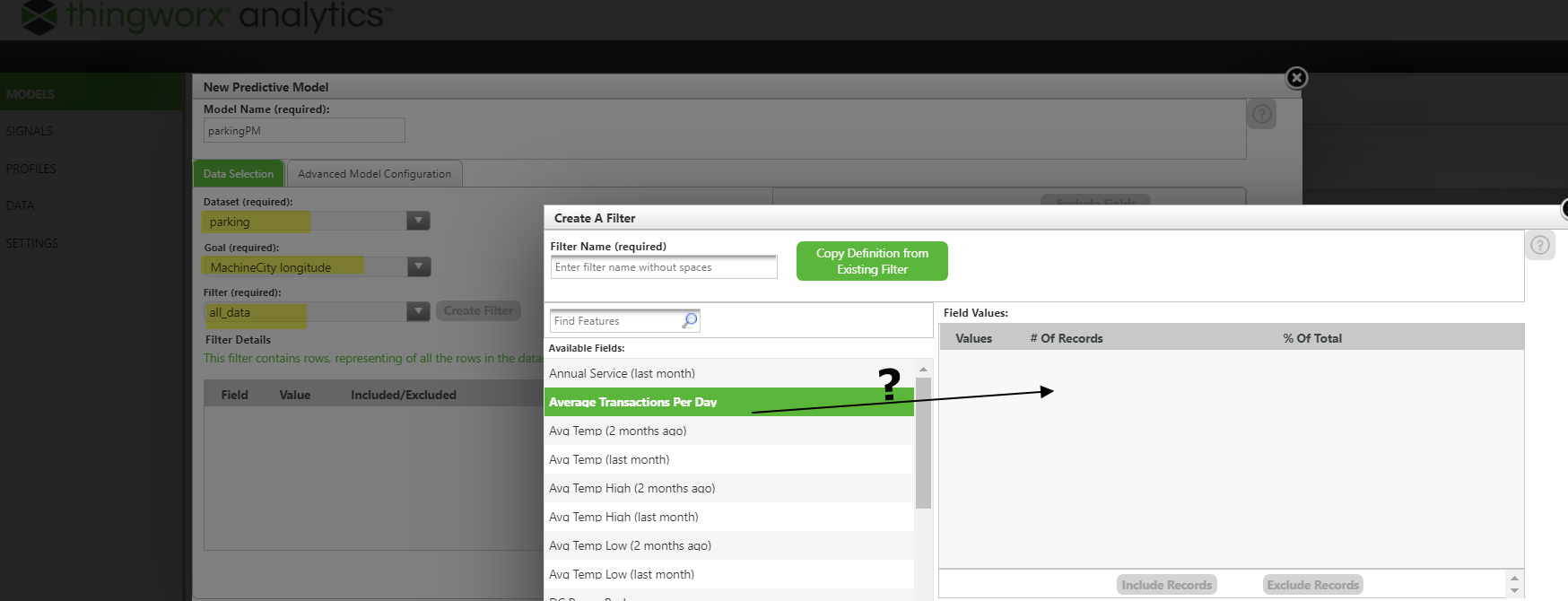

i can´t create a filter and don´t see any Field Values. I click on a random available field and no data is shown.
-     ThingWorx Analytics 8.1 Docker version installed.
-     Can´t find any error in the application.log or <<docker command: docker logs predictionms > C:\prediction.log>>.
Which logs are relevant for this ?
I´m also looking for better examples like the sample-data with step by step instructions for TW-Analytics 8.1.

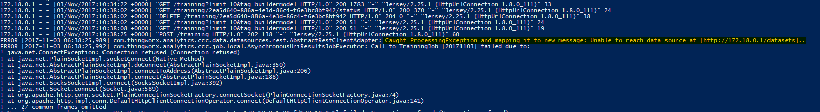

i can also upload the data successfully, but when i create the predictive model, no field values are displayed and after saving the model, status --> failed
All docker services running.
I found the following error in the trainingms container log:
I thing there is a connection problem between the dockersystem with microservices and ThingWorxCore ?

Hi Erik
For the original question on filters I have done a quick test and it worked for me with parking data.
It looks more like a browser issue, so you may want to try with a different browser and/or enable the browser debug mode to check for errors there.
Also you may want to try the following:
- add a name for the filter before selecting the feature
- create the filter from the Data menu instead of Model, select parking and View > Filter
