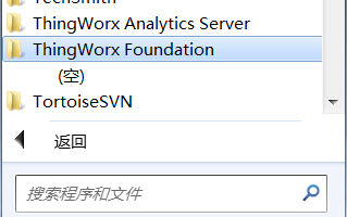

I am trying install ThingWorx-Platform-Docker-Installer-H2-8-0-2 SP2 by docker toolbox in Win7 OS.The first time it sucessfully installed. I can access Thingwor composer. But I don't know how to start it again after restart my laptop.The startup menu of Thingworx is empty

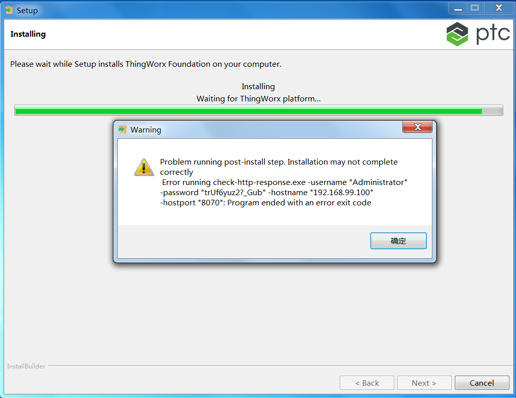

And I uninstall Thingworx, and try to install again I got error as the following screenshot:
(I found here https://support.ptc.com/appserver/cs/view/solution.jsp?n=CS264642&art_lang=en&posno=1&q=problem%20running%20post-install… is an article about the same issue,but it says this issue resoved in SP1, now I am using SP2)
I click Ok,and make the process complete. But can't access http://192.168.99.100:8070/Thingworx

Uninstalled Thingwox analytics Server(docker install in the same machine). And install Thingwox sucessfully. Issue resoved. TWA and TW are confilcted with each other.
