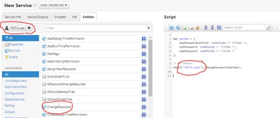

Hello everyone,
I am trying to change a user password from the frontend of my application, to keep it secure I need the user to first provide the old password and then compare the provided password to the stored password. Is there a way to do it? Where is the user password stored? Do I need to encrypt the provided password first? How do I achieve that the password is safely transfered from the users browser to server?
Thanks in advance for all the provided help and pointers,
Jiri
Best answer by iguerra
The "User" entity has a service called ChangePassword
It requires oldPassword and also newPassword+newPasswordConfirm
you can add a Dynamic user on the mashup (and set its EntityName with a service getting currentuser name), and then call the ChangePassword passing the 3 parameters from 3 textboxes (configured as password input by enabling MaskInputCharacters), no need to encrypt before. It works fine.
As I know all is managed internally into thingworx, there is no passw saved as cleartext.
If browser connects to thingworx with SSL, all the data is encrypted automatically
April 8, 2020
you can write your own service (and mashup) to wrap the in-built in functionality via snippets. You might want to add some conformity checks. Be warned, the in built function doesn't return any value to show success/fail.
You change the highlighted code to take the user's name.
