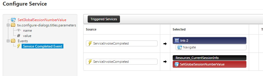

The Link widget doesn't have en event Clicked to bind out. You could use a Button widget with the Link widget (set to invisible in this case). When the user click on the button, execute the service SetGlobalSession..., then call the service Navigate of the Link widget.

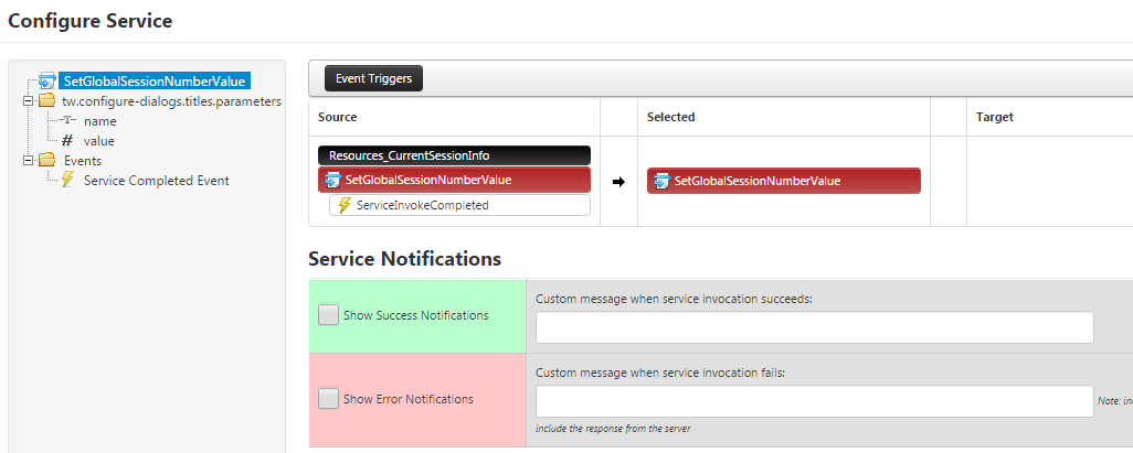

Did you try the Event trigger directly on the service setting the global session values, I haven't yet finished testing it yet but you can check if this helps

Thank you that was what I was doing till now, I wanted something cleaner but it seems there isn't yet.
