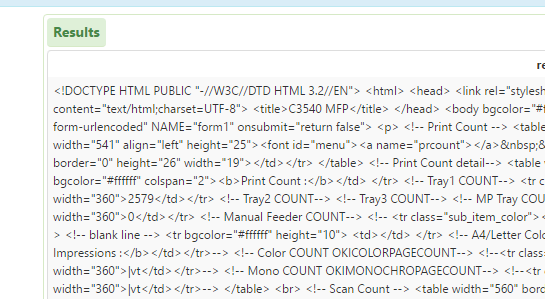

Connecting Printers is a bit of a different challenge. For example. Our multifunction office printer is an OKI and has web services.

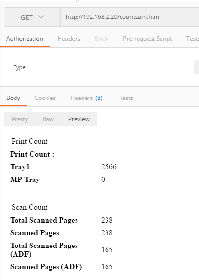

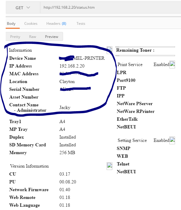

This is the view via Postman
This is some additional information via web services
The problem with this that the data is unstructured and in tables in html format.

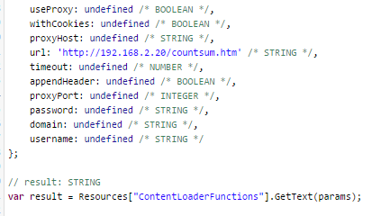

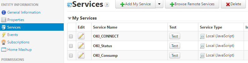

I have created a generic remote thing and a service to pull this data.
Which basically gives me this.
Any ideas of a better approach to this.?
Thanks in advance.

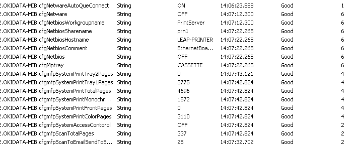

Could you do a Wire shark capture of the postman request for the countsum and attach a pcap showing the request and response. I may be able to build you an example using KEPServerEx's UCON driver that will send the post and parse the response for you.
BryanK17-PeridotAuthor
May 24, 2017
Hi Rob,
I have set up Kepware on my Test system and have successfully managed to connect using the snmp.
I found a "mib" that I just imported and and now I have multitudes of information.
All i have to do now is read that info into thingworx. (time to start reading help files)
The good part is i now know the effort required to achieve different levels of integration.
