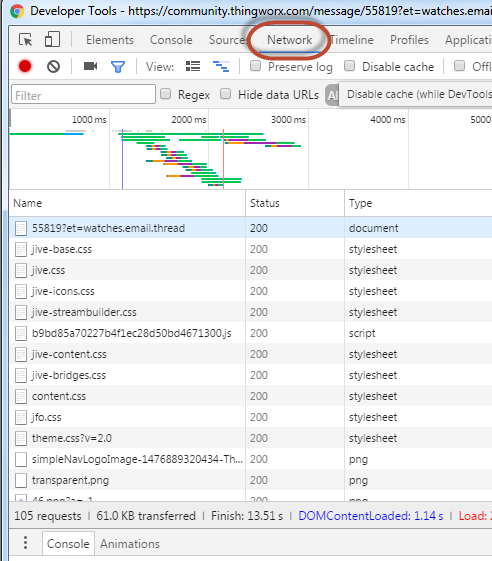

Hi Matthew, have you checked the tomcat logs for more info? Do you have HTTPS enabled? I think it could also be worth checking the debugger tool from the web browser at the Network section to see if it's somehow getting blocked.

Matthew, are you running Tomcat 8.5.11? (it's not yet officially supported) Additionally are you seeing this on all the web browsers available on your machine? Is there a reverse proxy configured on the VM? I think it could be worth a try checking the Network in debugger window (F12 for Chrome) just to see if there are any errors on the network itself

So i checked the network, there doesn't appear to be any errors but Combined.7.3.3-b67.20170320.031054.00743.js isn't finishing? I have also attached the HAR file for you to view.
