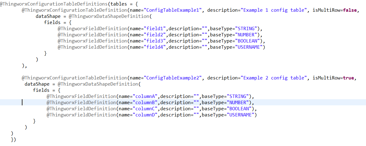

Hello All,
I am working in an extension that will create a ThingTemplate with some configuration fields and I would like to provide a list of choices instead of a free text input.
I am also considering making it a boolean field if I have only 2 choices but most likely I will have 3 choices and I'd like to provide the options and also the default values
The sample code helped me to create the config table:
Any Thoughts?

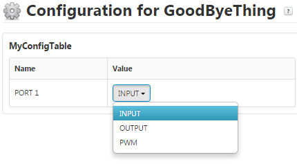

emoreira14-AlexandriteAuthor
July 19, 2016
Thanks Thearon, that did the trick.
It is actually quite simple once you get the syntax right! The only comment is that I actually put the VALUE in the default value field and it worked.
