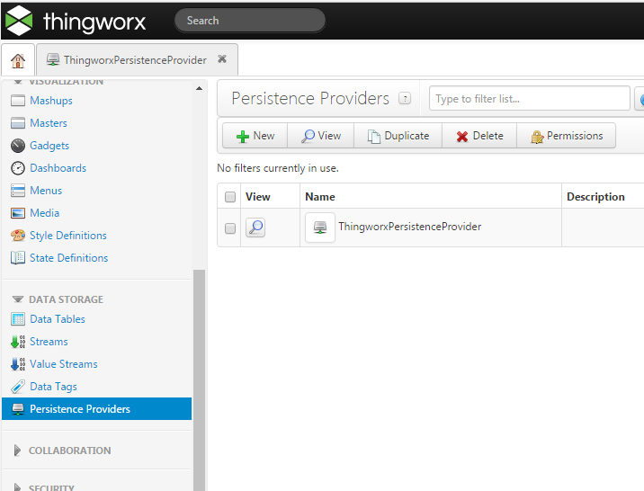

Generally speaking Neo4j and H2 for that matter are "hardcoded" within the ThingWorx. Though you can still view the database files if you'd to navigate to \\ThingworxStorage\database\data , ThingworxStorage\database\ (for H2) Also you can check what sort of PersistenceProvider ThingWorx is using if you'd navigate to PersistenceProviders under the Data Storage, something like this :

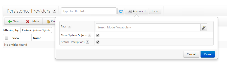

just in case if you don't see this listed, enable the visibility of system objects by :

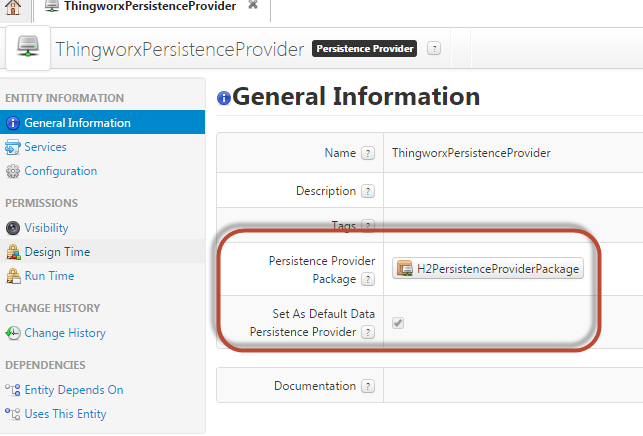

And if you'd click on the icon you should see which DB is used as persistence provider :
