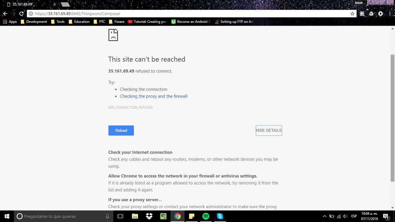

I have followed the tutorial to install Thingworx 7.2 on Ubuntu. After finishing the walkthrough and try to access from within Ubuntu (localhost), and from outside (public IP/public DNS) both keeps sending this error message:
My firewall is already down and the port 8443 is setted in config.xml.
Thanks on advance.

Are you able to connect on port 80 at all?
jserrano1-VisitorAuthor
November 10, 2016
No, not at all
November 10, 2016
Are you able to share the console output from starting up your thingworx instance ?
February 24, 2017
Have you tried opening port 80 on the EC2 instance? I followed this guide from Amazon and then chose HTTP instead of SSH to open port 80 and then it worked fine.
Authorizing Inbound Traffic for Your Linux Instances - Amazon Elastic Compute Cloud
