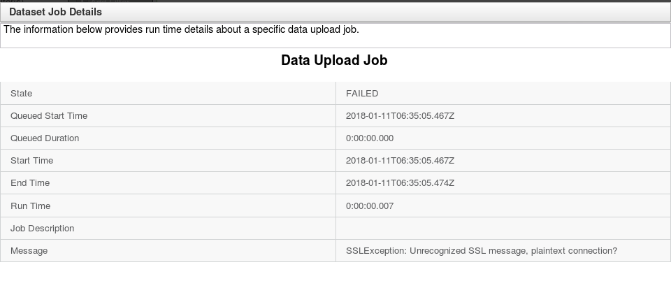

I implement a service that create a json and a csv file consisting on a given thing. This both files will be sent via AnalyticsServer_DataThing.CreateDataset() to Analytics. Relatively common I get an SSLException on anyltics (job details):
When it comes to this error it does not work to add a dataset via the analytics mashup either. I get the same error. On Analytics settings SSL is unchecked, and I'm not using a SSL (because I working on a local mashine).
Sometime it help to restart analytics or the maschine where its runs.
PS: I'm using Thingworx 8.1.1-b108 & Analytics 8.1.040000
Best answer by drichter
Ok, problem solved!
For the path of the csv and the json file I used thingworxs://... but this is only for using SSL. Now I use thingworx://... and it works.

Hi David,
Could you please paste a sample of your Dataset inccluding the header Line as well as the json metadata file which are created through the service you implemented ?

The error seems quite random. Sometimes its work fine, sometimes I get this error. After a server reboot, it usually work fine - but not always.
drichter1-VisitorAuthor
January 16, 2018
Hmm, if I first create a dataset (after start the server) via analytics builder mashup everything are fine and I can create datasets with my code. If I first create dataset with my code I must restart the server to avoid the SSLException. I think the analytics mashup is set something that my code is not set.
