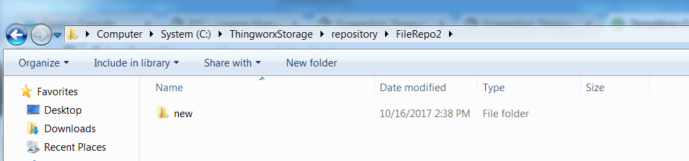

When I create a new repository. It does not show up in the folder path of C:\\ThingWorxStorage\repository\newRepository. I using Thingworx 7.3.3. It was working as expected but not anymore. I tried restarting my computer but no luck. Any ideas?
In advance thank you for your help,
Wendy

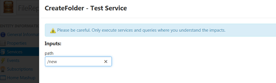

Assuming you created a thing that implements the FileRepository template. Go to Services ->CreateFolder in the file repository thing and try to create a new folder.
/new would create the File Repository and create a folder in it. You can later delete the  new folder, if not needed.

Thank you that worked.
