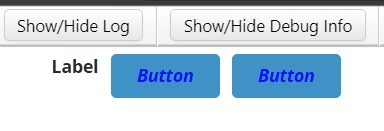

I'm trying to follow the new custom CSS syntax for Part
@supports (ptcs-style-unit: "PTCS-BUTTON.primary") {
 [part=label] {
 color: Blue;
 font-style: Italic;
Which affects all the buttons in the mashup
How to apply this custom CSS for specific button using CustomClass property
Thanks in advance

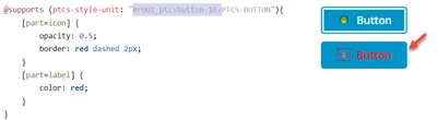

Hi @Velkumar
You can use the DOM element ID to target a specific button rather than applying to all buttons.
Find out the ID from browser developer tool.
Use ptcs-style-unit: "elementID.PTCS-BUTTON"
Note that this syntax doesn't support class name to target the component for now, it's in the backlog and might be realized in the future.

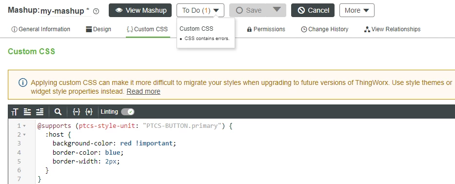

There is no example of how this would work. I don't believe it works at all.
More than that, I get an error saying my "CSS contains errors.", yet there is nothing in the CSS editor to say anything about said errors, and EVEN worse, the CSS is the exact one in the documentation. Doesn't let me save the mashup because "CSS contains errors" and to save it you have to "View Mashup".
Getting this message is kind of amazing:
Applying custom CSS can make it more difficult to migrate your styles when upgrading to future versions of ThingWorx. Use style themes or widget style properties instead. Read more
These features are so uselessly locked by using web-components for widgets.
I would stick with the old way of styling with CSS for these web-components.:

Hi @GabrielB
We are still using the old method but for some widgets old syntax is not working.
For your issue, just turn off the linting option to save it.
I'm just exploring this new syntax

Hi @Velkumar
Velkumar19-TanzaniteAuthor
Jul 11, 2023 5:38 AM UTC
Hi @TonyZhang
It works perfectly. Thanks 🙂
