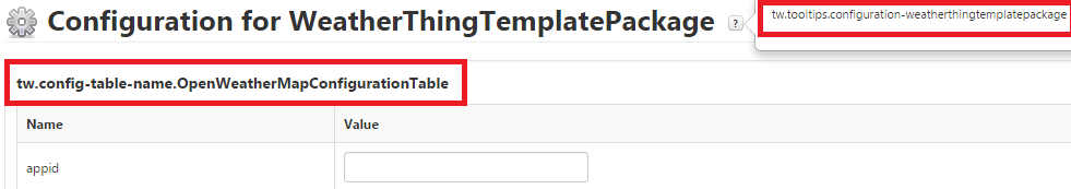

when i implement and import an extension e.g. with a configuration table, the title and tooltips of the configuration table won't be displayed.
Has anybody got any idea how to fix this?

Hi Ankit,
thank you for the response.
I am creating a Java Extension.
I also thought adding the description would have an effect, but it didn't.
