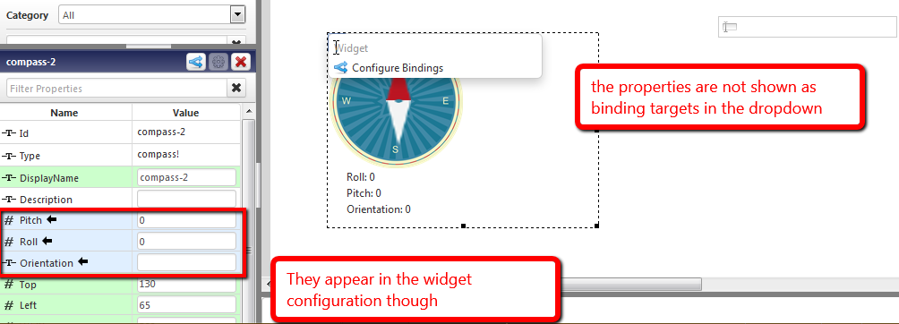

Hello everyone,
I am building a custom compass widget and I am not seeing the names of the properties of the widget appearing as a binding target in the dropdown menu of the widget.  Nevertheless I can configure the bindings from the Configure Bindings menu.
What should I do to have them appear also in the dropdown menu like for the other ThingWorx widgets ?
This is how I declared the properties in the compass.ide.js file :
this.widgetProperties = function () {
    return {
      "name": "compass!",
      "description": "A compass Widget",
      "category": ['Common'],
      "properties": {
        "Pitch": {
          "baseType": "NUMBER",
          "defaultValue": 0,
          "isBindingTarget": true
  "Roll": {
          "defaultValue": 0,
  "Orientation": {
          "baseType": "STRING",
          "defaultValue": 0,
Thank you,
Veronica
Best answer by bconnell
Binding sources -- not binding targets -- appear in the drop down.
bconnell1-VisitorAnswer
September 22, 2015
vmihai1-VisitorAuthor
September 23, 2015
I see. I didn't realized that.  Thank you.
