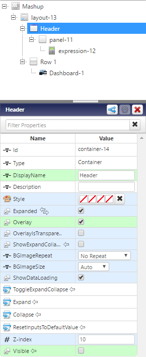

I found a workaround for this, it's not pretty, but it works in responsive mashups.
Make your header invisible and overlay. Mine has 5px height.

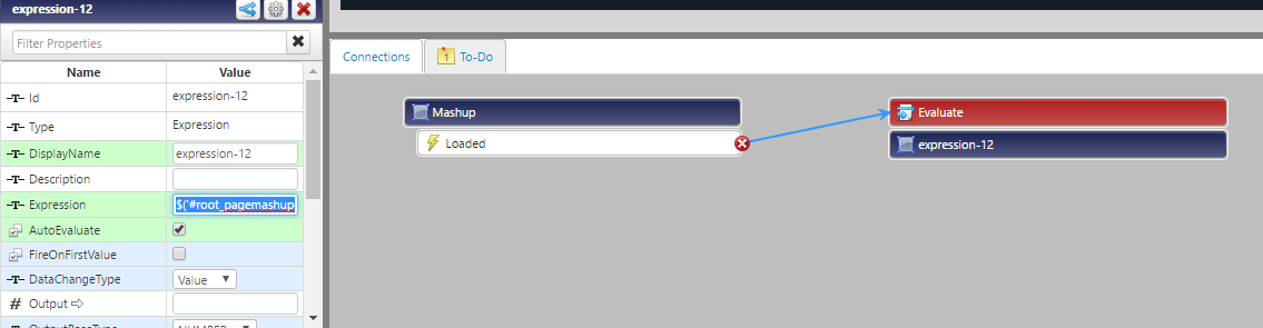

And your expression should contain:
$('#root_pagemashupcontainer-6_Dashboard-1').css({overflow: 'auto'})
You can see which number your dashboard has in the properties of the widget. It's the first property > Id.
Make the expression Autoevaluate and get Mashup Loaded to evaluate it.expression.png
Hope it helps!
This is a way to do it if you want your dashboard to occupy the whole mashup.
BR,
Gabriel

Hey guys,
Hope it helps!
BR,
Gabriel
Edit: found a way without Framelayout.
