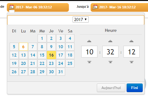

I just saw this small issue with my datetime picker widget :
On the top of the box I should see the month and arrows but I see nothing. When I check the css at the runtime, they are here but most of their properties are not used and it's why they are not displayed.
But the question is why ?
I changed the button style and localization tokens but even if I revert my changes it does not solve the problem.
If you have any ideas.
Best answer by ankigupta
Hi Jean-Noel DURAND​,
I have seen something similar. Have you imported ThingWorx analytics extension(s) in your ThingWorx?
To be specific; I saw this error with RangeSlider Extension. Try removing this extension if it resolves the issue.

Hi Jean-Noel, which version of ThingWorx are you using? Is this something you are observing on all the web browsers? I can't reproduce this at least on ThingWorx 7.3.1
jdurand1-VisitorAuthor
March 16, 2017
I am using ThingWorx 7.2.3 and I experience the problem with Chrome & Firefox.
Maybe I should try to upgrade ThingWorx.
ankigupta5-Regular MemberAnswer
March 16, 2017
Ankit Gupta
