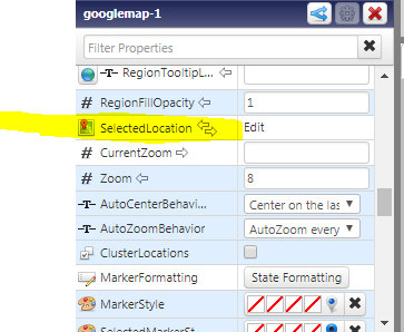

I want to load Google Map widget with some default location as the Mashup loads for the first time. My map will display markers for the locations bind from service,after an event but I need to show some temporary location when it loads first time.
It shows the region of Philadelphia,every time the Mashup loads.Is there any way to change it?

You could try presetting SelectedLocation on Mashup load:
