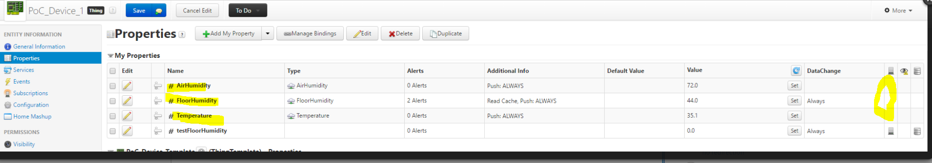

I successfully simulated my computer as several device, sending simulated data, generated from the Lua Script Agent running there, to the ThingWorx platform.
You can see on this first screen one of my device, with inside 3 parameters :
- AirHumidity
- FloorHumidity
- Temperature
which are updated automatically with the wsems and luascript running on my computer, as you can see on the screen below.
When i created my mashup, as i did during the first tutorial which works well, this time i had no data displayed.
To be sure of what happened, i decided to try something with the Time Series Chart, and if you look on the
bottom left of the screen below, on the DataField1 section, you will only see the local property testFloorHumidity, and not the other properties, catched from remote device.
My question is, how can I do to display data from remote device on Mashup Composer ?

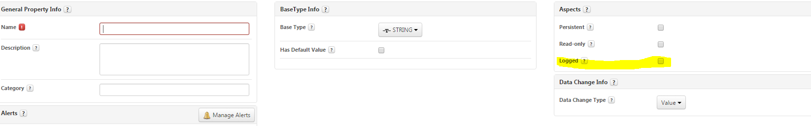

Best answer by dupatel
Jordan Goasdoué​ : The issue seems to be that you have not logged the below properties:
- AirHumidity
- FloorHumidity
- Temperature
To fix it , edit the property and tick logged.
After doing this you should see the property values from your remote device.
-Durgesh
- AirHumidity
- FloorHumidity
- Temperature
-Durgesh
April 4, 2017
Hi Jordan Goasdoué​,
To add what Durgesh mentioned; the TimeSeries shows only Series Data.
If we are not logging the Property; there will no Series created for that property. Also, the QueryPropertyHistory Service won't even have that coumn as output.
So, we need to log the Data to show it in the Chart.

Thank you for both your answers, it fixes my problem.
Cheers !
