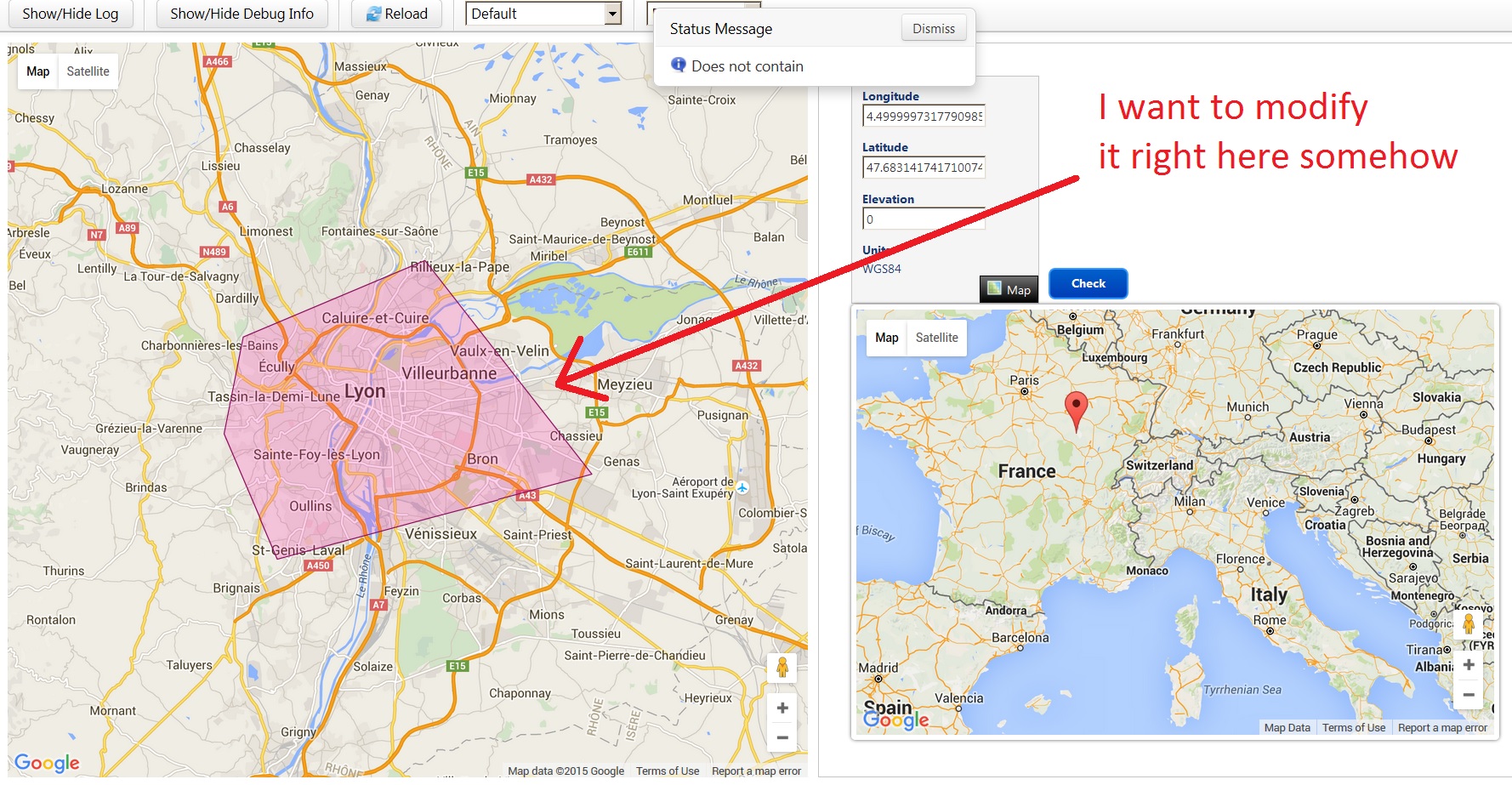

I'm prototyping a mashup containing a map with some geo-fence / region overlay.
I would like to give a user the possibility to define their own regions, but it's not very convenient with the GoogleLocationPicker widget, the grid with points, add/delete buttons, etc... Ideally I would like to have the possibility to drag locations over the map and add/delete just like when you specify the routes in Google Maps.
Is any of that possible?

Dragging is not supported. But you can have them directly pick points on the Google Map, the Google Map widget supports SelectedLocation
