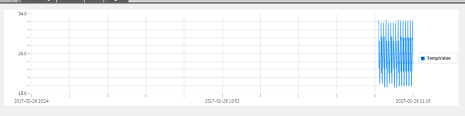

Whenever i try to use the time series chart i always get some empty space at the start, this is quite annoying and is never in any examples I've seen.
Anyone know how to get rid of this?

February 28, 2017
If you are using the default TimeSeriesChart widget, try to uncheck the property "XAxisSmoothScaling"
mfelton1-VisitorAuthor
February 28, 2017
Just confirmed that this is already unchecked.

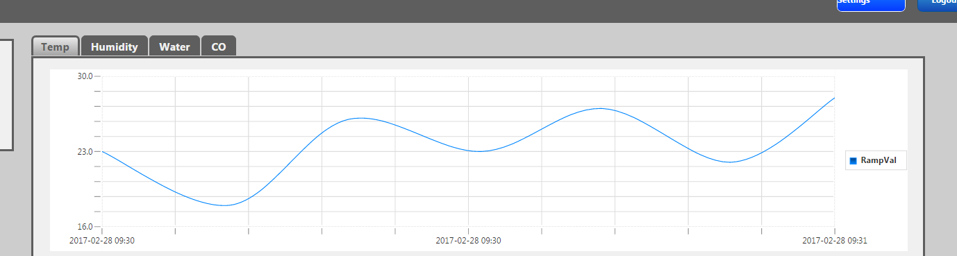

20-Turquoise
February 28, 2017
I don't have a kep thing connected, so I changed the value to the RampVal in place of the TempValue, here's what I'm seeing:
Do you have a start date set in your query that preceds your actual values' start time?
