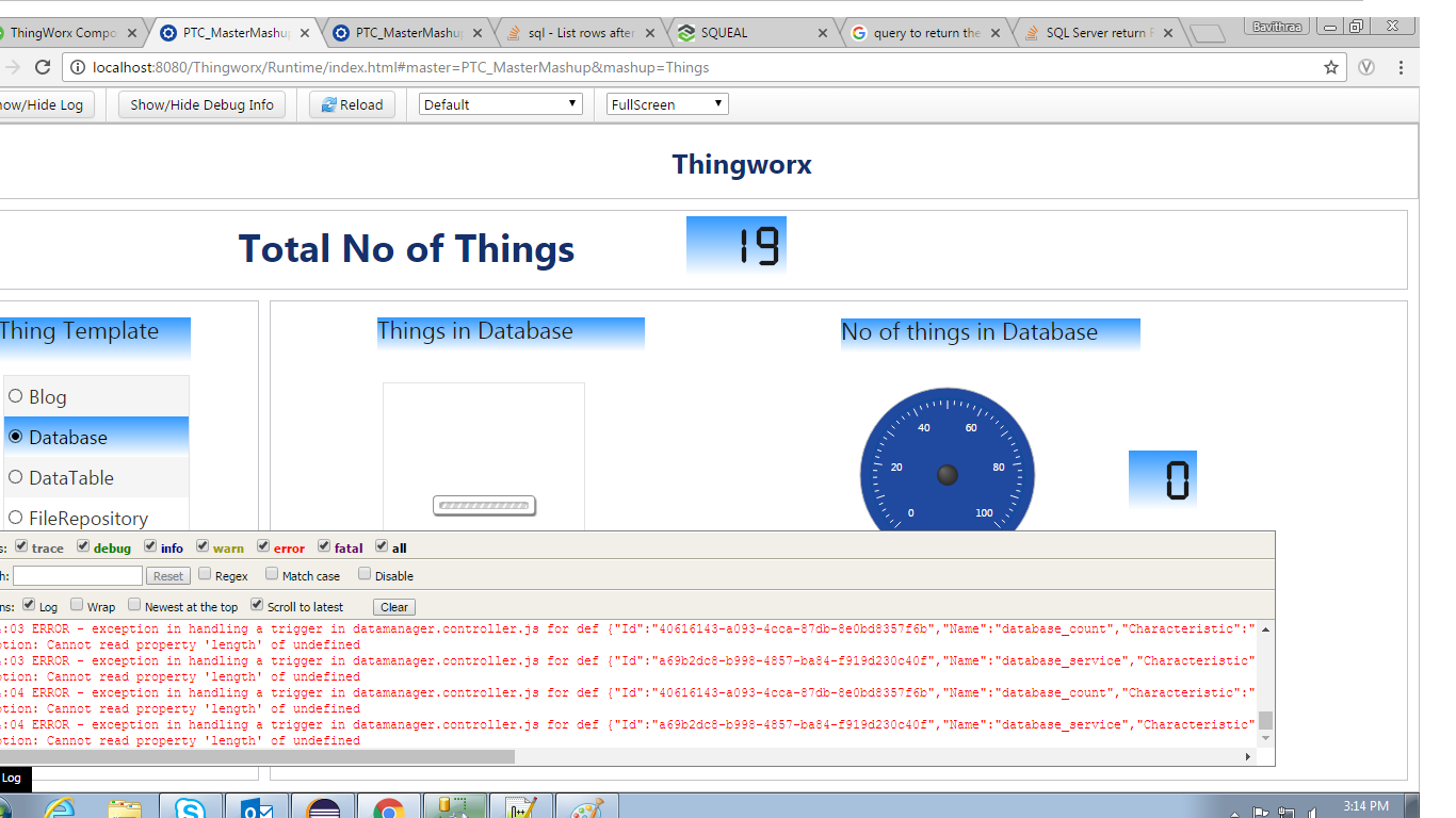

Here for each row of the list, I have binded with individual mashups. But when I choose further rows, other than blog ,it flickers among other rows and also getting error as
15:07:08 ERROR - exception in handling a trigger in datamanager.controller.js for def {"Id":"40616143-a093-4cca-87db-8e0bd8357f6b","Name":"database_count","Characteristic":"Services","Target":"database_count","APIMethod":"post","RefreshInterval":0,"requestNumber":1,"entityTypeToUseIfEntityNameSet":"Things","alreadyBeingInvokedDuringMashupLoaded":false,"DataName":"Things_things_data","isDestroyed":true} Exception: Cannot read property 'length' of undefined

What version of thingworx is this? Also, what browser -  please check the behavior in a different browser?
Could you please provide some more details on your bound mashups? I see you have a list and then selected row logic.It would be very helpful to see the full structure of your bindings. Perhaps there is some service input/output type mismatch? Seems like one of the services might be manipulating a property named "length" but its type not being defined within the service.
EDIT: Do you have any custom widgets installed?
February 21, 2017
Bavithraa, just to check is the service getting all the things from the database is working fine otherwise, for e.g. if you'll test the service do you get valid result? What sort of service is this, SQL or JS?
