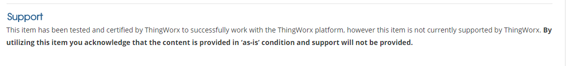

Please note that the extension has been tested and certified for ThingWorx 7.2 but is no longer supported.
ThingWorx IoT Marketplace
