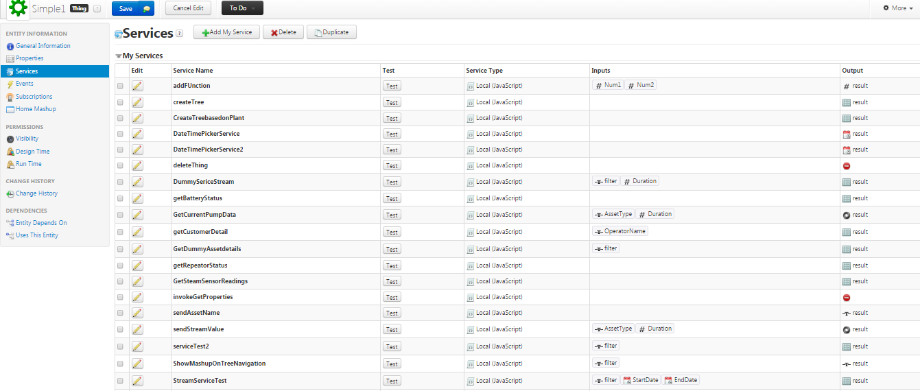

Dear Team,

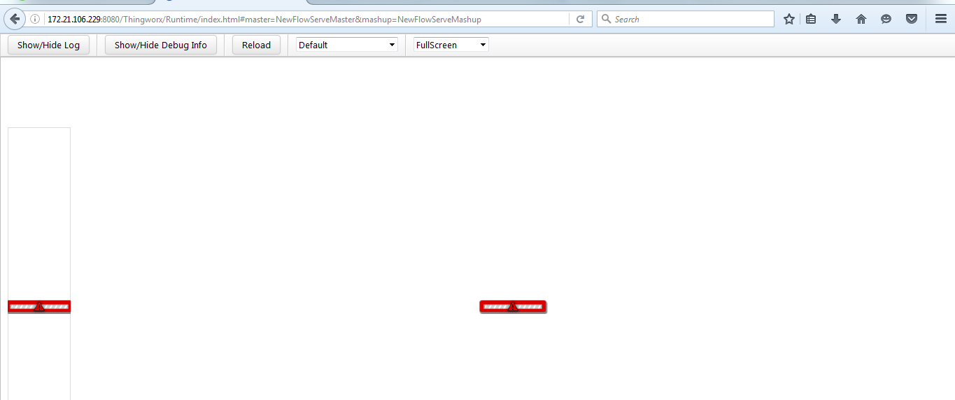

I am getting error when I am login by Plant Operator1 belongs to PlantOperator (non-administrator). I have given access to all service which is written in Simple1 Thing. but I am opening mashup still getting error.
Execution error in service script [Simple1 getCustomerDetail] : Wrapped com.thingworx.common.exceptions.InvalidRequestException: Not authorized for ServiceInvoke on CreateValues in LoginUsersDatable Cause: Not authorized for ServiceInvoke on CreateValues in LoginUsersDatable

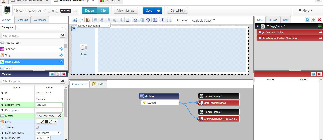

Mashup View

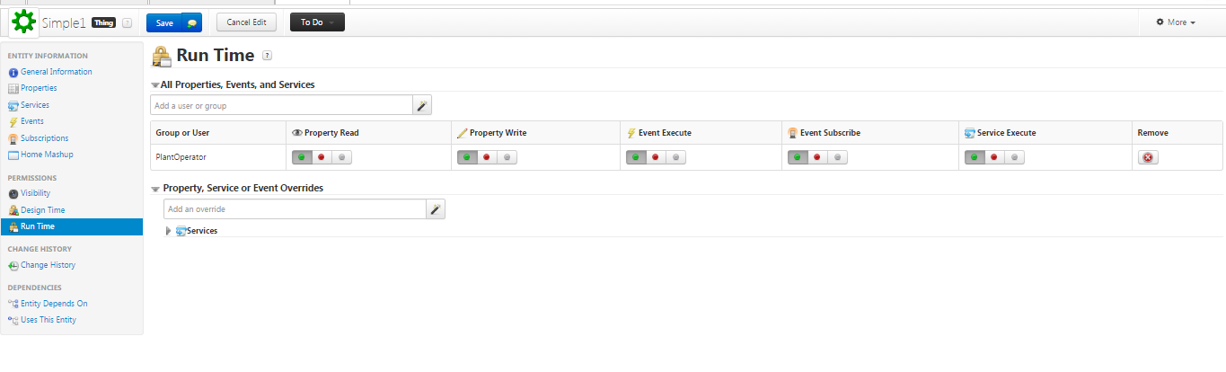

But when plant operator1 viewing page
Run time access to PlantOperator

    Hi Bhuwaneshwar Gupta​,
    This is a Permission issue.
    This suggests that User does not have RunTime Permission to execute the CreateValues in LoginUsersDatable.
    Please provide requisite permissions to the user to resolve this error.
