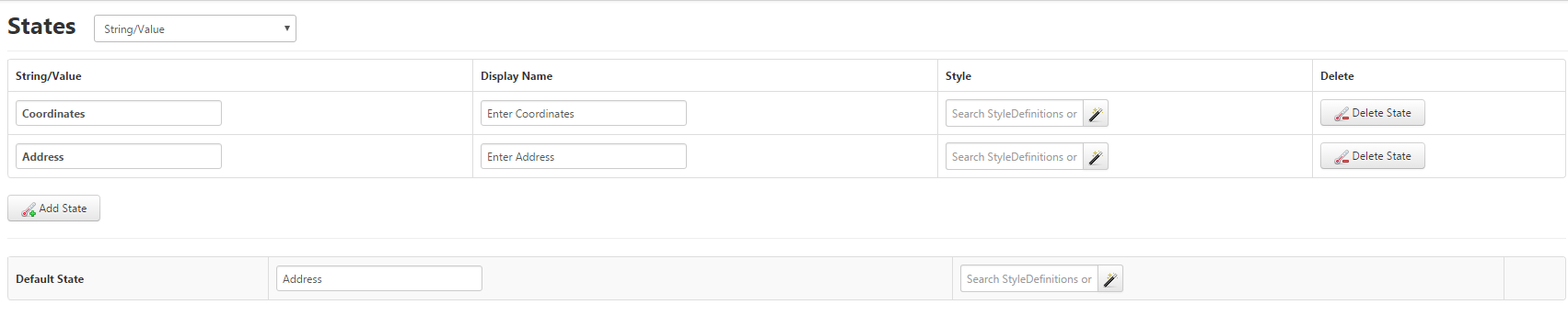

I'm using a radio button to allow the user to choose between entering the coordinates in directly or an address which will be changed into coordinates. But the radio button does not select the default state. Below is my state definition, I have tried using both a radio button and a generic radio button.

What is your Thingworx version?
cjones-51-VisitorAuthor
April 4, 2017
6.0
20-Turquoise
April 4, 2017
It was fixed in 6.5
April 4, 2017
so default has zero functionality on radio buttons before 6.0? I can do a work around then.
posipova20-TurquoiseAnswer
20-Turquoise
April 4, 2017
actually, should be in the latest patch of 6.5
April 4, 2017
Okay, we'll be able to use it once we upgrade then I guess.
