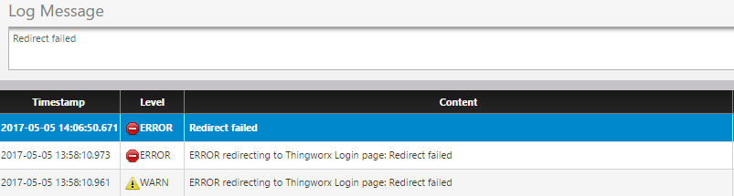

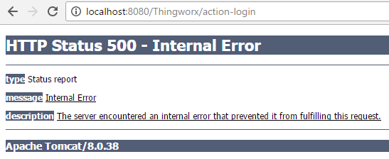

Hello there, I'm hoping someone could assist me with the following.
I've updated ThingWorx test platform to version 7.4. Everything seems to work fine, however, FormLogin access is not functioning as expected. I'm trying to gain access using existing user's credentials. The user is a member of a users group which has a visibility set to the appropriate organisation. There are no problems accessing ThingWorx composer directly.
Best answer by posipova
We do not support Postgresql 9.6. Currently the only supported major version is 9.4 with 9.4.5 minimum.

Could you please provide your tomcat version and backend database? I will recreate your environment to reproduce and come back with my findings.
Michail1-VisitorAuthor
May 5, 2017
Polina Osipova​,
psql (PostgreSQL) 9.6.1
Apache Tomcat/8.0.38
Win10 x64
posipova20-TurquoiseAnswer
20-Turquoise
May 5, 2017

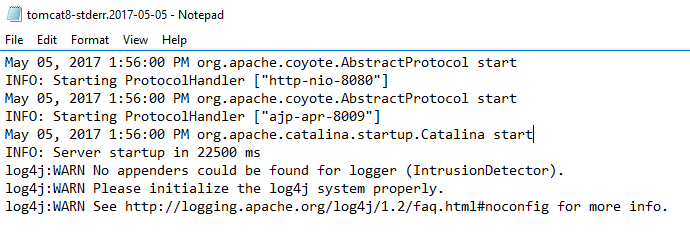

May be it's bit too early to say but it could be an issue, there's already a Jira PSPT-3573 on redirect issues for Manage Extensions (which BTW do log this intrusion detection stuff in application log) mashup not addressable from Composer and also related to Organization Form Logins not able to redirect. Though i'm not 100% if this is what you are also running into.
None of this is reproducible when doing fresh installation of v7.4.

Hi mnudel​,
Is this a new installation or upgrade.
If it was a upgrade what was the Upgrade process followed?
Also, try to open the Thingworx logs; does that page also fail to open?
May 5, 2017
Ankit Gupta​, it was indeed an upgrade. I also had troubles with the Logger page - with particular services failing and some graphical elements failing to upload. I followed installation process, prior to that I deleted ThingWorx database, undeployed .WAR file and removed associated files.
