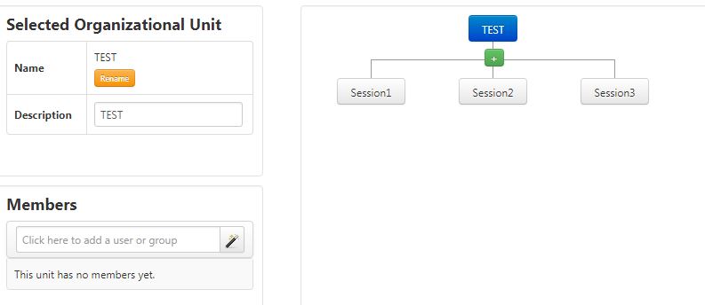

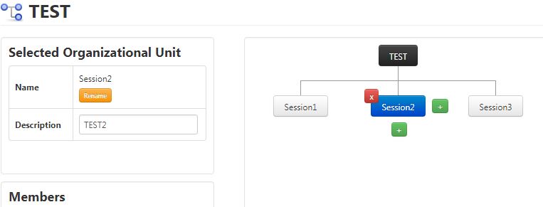

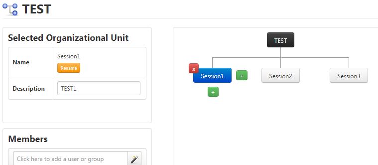

I have created an organization with 3 Sub Organizations,
it's possible to read the description of each of them?
The result I expect is to be able to have as values:
TEST
TEST1
TEST2
I've tried with Org's services. But I can only get the description of the General Information for the Unit.
Thnx
Giuseppe
