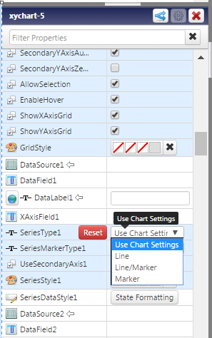

For Query2:
I can find the SeriesType1 property in xy chart widget properties. Are you using version 2 charts?

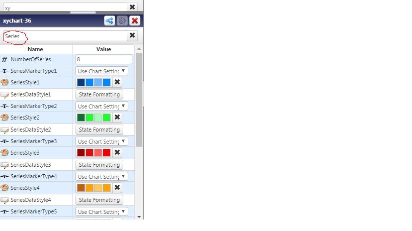

HI Ankit Gupta​,
For a plain XY chart widget, i.e. no binding has done yet, I can see this SeriesType1 property in xy chart widget properties. Once I bind All Data of returned data from QueryPropertyHistory, this SeriesType1 becomes invisible.
May 5, 2017
Hi azim hawaldar​,
Use Label chart and bind data with X and Y axis column
Set chart property as following:
Chart Type: Line
XAxisField: X axis column
DataField1: Y axis column
View the chart:
