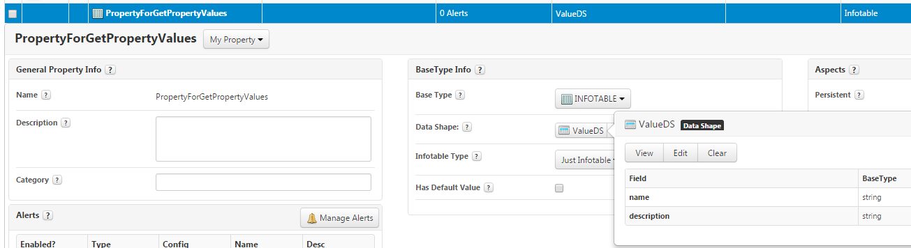

Here's a quick demo
1. Created a Infotable with DS that has filed name and description, of course you don't have to create a property with Infotable like this you can simply create that in your script

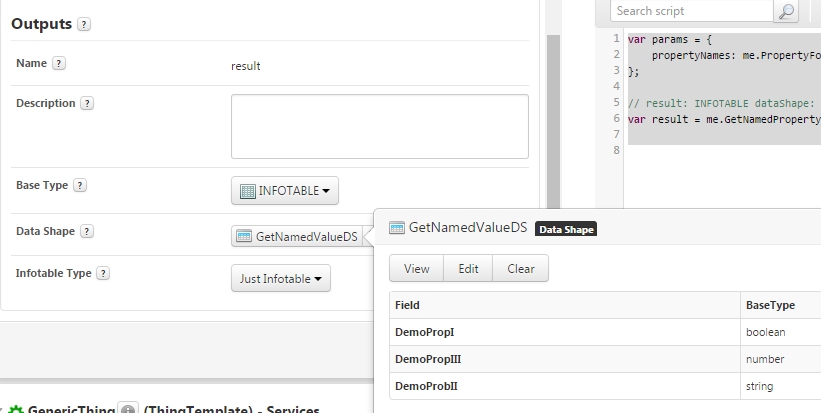

2. Here's how my service looks like :
var params = {
  propertyNames: me.PropertyForGetPropertyValues /* INFOTABLE */
// result: INFOTABLE dataShape: "undefined"
var result = me.GetNamedPropertyValues(params);
3. Do note that my returned output contains the DS which matches with the required Output for my data, like so
Hope this will help.

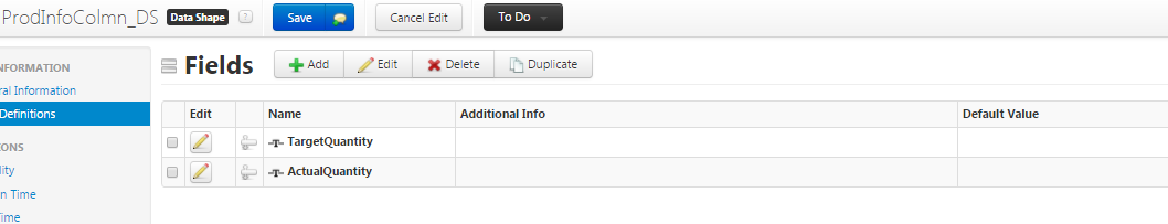

Hi Sushant,
Datashape is also having only two properties.
sharing screenshot of datashape.
Also cross checked infotable level also.its having only two columns.
Raji
May 22, 2017
Raji I think the issue here is that you are passing the values for the property to the GetNamedPropertyValues where as it's expecting Infotable which contains the DS that holds the PropertyName. You can check this by testing the GetNamedPropertyValues service and you'll see as an input it requires you to enter the propertyName and description. In which PropertyName is a mandatory field.
So you'll need to pass such an Infotable and the values that you want to insert and I think the PropertyNames should match to the PropertyName you have in Thing
