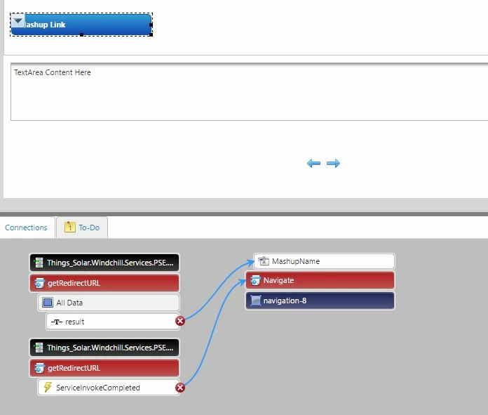

I am getting error message when setting "MashupName" property dynamically for Navigation widget, but the URL works fine when paste directly to the the address bar.
This link works fine using browser address bar:
"<server_name>/Thingworx/Runtime/index.html?key=9Uvv.Qc4hJrJ4d041Pl8mQjd2m..2e3iil4nQjjr53Ve3.2088u.ei-5Ma11r1i#master=Solar.Windchill.MasterMashup.PSECycleTime.FM&mashup=Solar.Windchill.Mashup.PSECycleTime.FM"
but I get error message using Navigation widget when I setup the "MashupName" property dynamically using a service (please see attached image for connections:
Status Message
Dismiss
Could not load "<server_name>/Thingworx/Runtime/index.html?key=9Uvv.Qc4hJrJ4d041Pl8mQjd2m..2e3iil4nQjjr53Ve3.2088u.ei-5Ma11r1i#master=Solar.Windchill.MasterMashup.PSECycleTime.FM&mashup=Solar.Windchill.Mashup.PSECycleTime.FM". Reason: 404 - Entity Not Found : [http:]

    Hello Hemant,
    Did you put the link directly to the Mashup in the MashupName field? It seems that it receives a URL as the input.
    Actually you should send the entity name in the composer to the property, in this case it might be "Solar.Windchill.Mashup.PSECycleTime.FM"
    May 31, 2017
    Following that, if you want to dynamically direct to a Mashup, either put the URL dynamically to a Link widget, or use a similar service to assign MashupName property dynamically to Navigation widget.

    Attached is a basic example on passing the mashupname to the navigation widget. Import the entities and view the mashup "DynamicNamePass"
