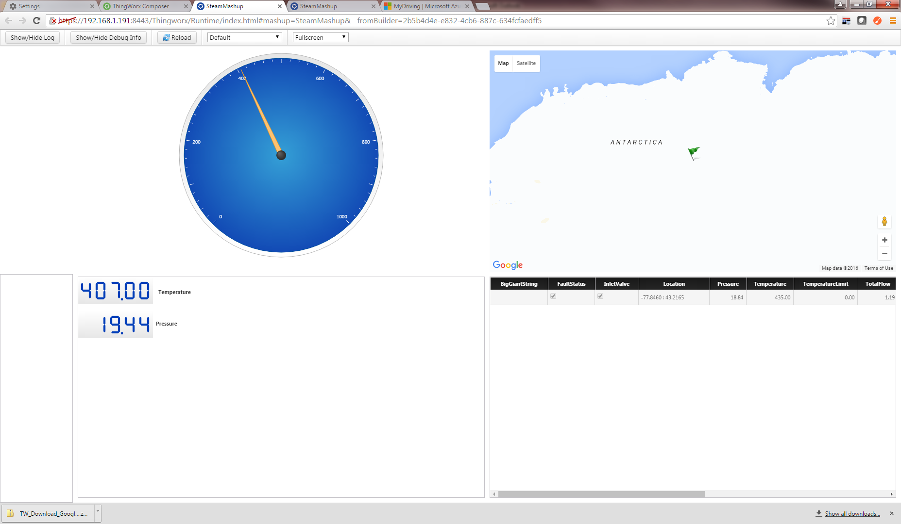

I have a remote device running the SteamSensorWithFileTransfer example code.
I can verify that the device connects and transmits location information - I can see the location being sent from a trace on the device, and if I use a table or label widget I see the values correctly appear.

The problem is that the Google Map Extension I installed doesn't seem to display the location correctly.
Here is a screen shot - as you can see the location appears in Antarctica- but if you look closely you can see my Lat and Lon are no where near there.
I based my google map widget settings off the tutorial - so I have ShowSelection Marker checked and my Location is linked to the SelectedLocation data item in the widget

If I search in Google maps with the co-ordinates shown as location in your grid, it goes to the same location in Antarctica.
If I reverse the co-ordinates, I end up near Rochester NY.....

I missed that - thank you. Of course it was something simple.
I double checked and the bug is in the example src for the c-sdk
properties.Location.longitude = 43.221462;
properties.Location.latitude = -77.850917;
