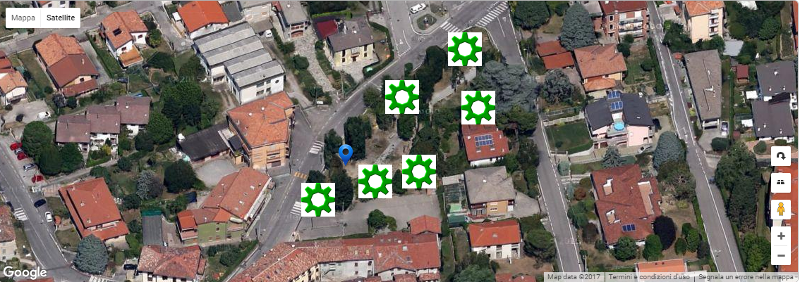

I have a problem with the GoogleMap Widget. When the widget shows more markers on the map only the selected item has the correct icon; the others show a wrong icon (see screenshot below).
Best answer by flucciarini
I find the problem.
MarkerField properties is setted to avatar, I resetted the properties and now work fine.
Thanks to all for support.

What is your version of Thingworx, tomcat, java, and operating system?
Have you tried in a different browser?

Fabrizo,
You can find information on how to work with multiple icons here: https://support.ptc.com/appserver/cs/view/solution.jsp?n=CS235093
Has anyone else seen this behavior in their Google widgets?

I find the problem.

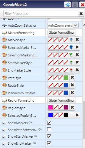

My Google Map don't have that problem when showing multiple icons, so please show us the screenshot of your list of styles ( as shown below), and MarkerFormatting if you have put anything inside.
Another question, was it always shown like this (use Gear icons as markers) ? Or maybe when you have fewer items, every marker appears normally, while as the number of the items increase, not selected markers suddenly became gears?

Hi Fabrizio Lucciarini​,
Please reset your Marker style property for the Google Map.
Secondly, could you please check that if you are using state formatting; if yes; please review it and make sure it does not set the Gear icon.
Do let us know in case of any queries.
