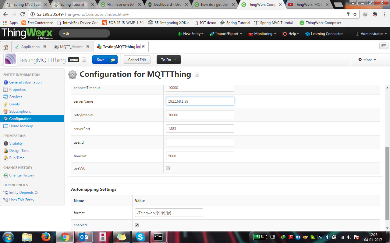

Hi Stephen,
Happy new year...

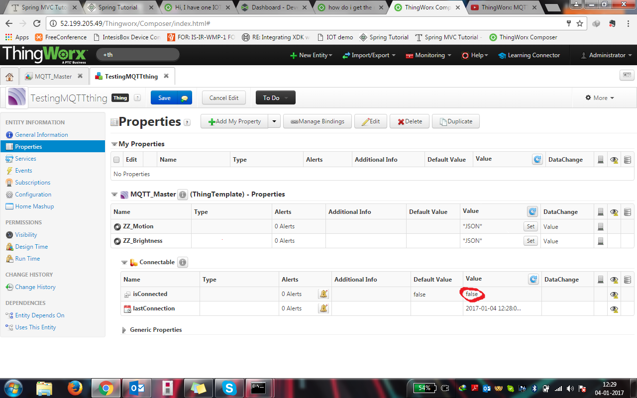

I am unable to communicate with my MQTT broker. Thingworx server and MQTT broker both are running in my laptop only. I think some problem in my Thingworx MQTT configuration page. please guide me to resolve this. This is my configuration screen. (My laptop IP :192.168.1.89)
After configuration,
I have one more question,

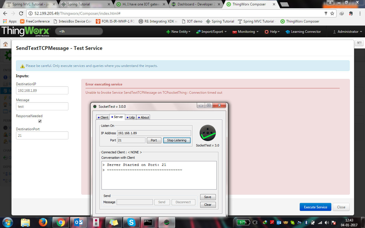

During TCP communication I am getting Unable to Invoke Service SendTextTCPMessage on TCPsocketThing : Connection timed out , TCP server and Thingworx both are in same network. This is my Screen. I already spent more then 2 days in both cases, Please provide some support to resolve this.
Thanks in advance.
