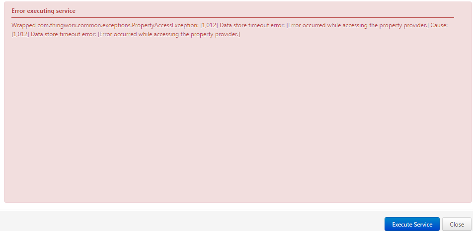

Hi When i execute service come err
  • May 26, 2017
  • 7 replies
  • 3084 views
Hi i make service
that is get data from postgreDatabase
is doing loop when data End
so yesterday it was done
but today when i execute service
come err
so i try find this  err in this community
but i can't find
could you help me plz?
thanks
Best answer by AnnaAn
Hi Seonho Cha,
The error message you saw here may be a little misleading. To check exactly what's the issue, you could try to enable stack trace.
will contain the underlying reason for the error.

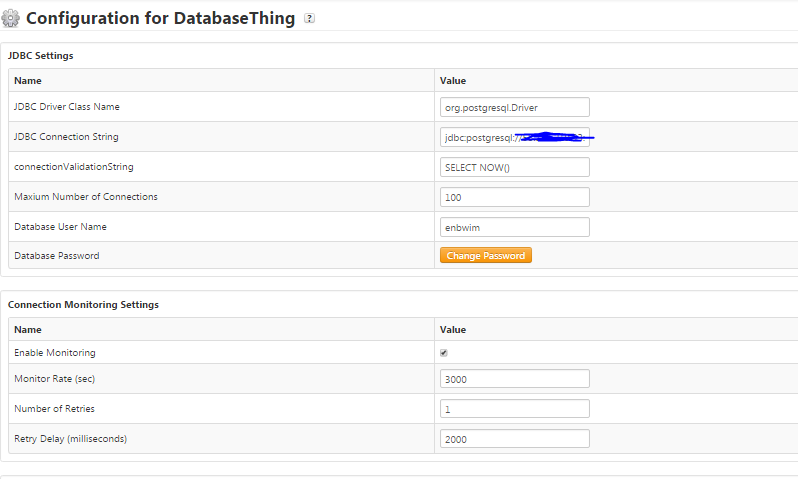

Hi Seonho Cha,
Could you attach your code here too?
If possible, please also provide your postgreSQL database connection configuration in ThingWorx(I suppose thePostgreSQL database you mentioned is as an external db not the persistence provider here, correct?)
Br,
Anna

and my configuration
thanks
May 26, 2017
Hi Seonho Cha,
Indeed the code is so long and it contains many other logics besides the database query.
Could you please split your functions and just create another service for the postgreSQL query part? see if it work or not and you could attach that part of code here if you like.
Br,
Anna
