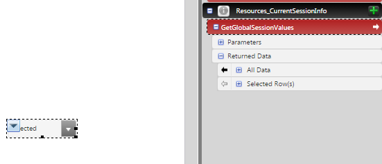

How can I bind the session variable to dropdown list? Is it only a one way binding?
But in Text box, it works fine.
    Best answer by posipova
    I have a dropdown list on the left here and the GetGlobalSessionValues from CurrentSessionInfo service bound to it:
    Then i need to configure the list widget itself in the following fields:
    7 replies
    April 29, 2017
    Create a getter service on a thing that reads the data stored in your session variable and returns an infotable.  Bind the All Data from your getter service to the dropdown list.
    var result = Resources["CurrentSessionInfo"].GetGlobalSessionValues().<YourSessionVariable>;
