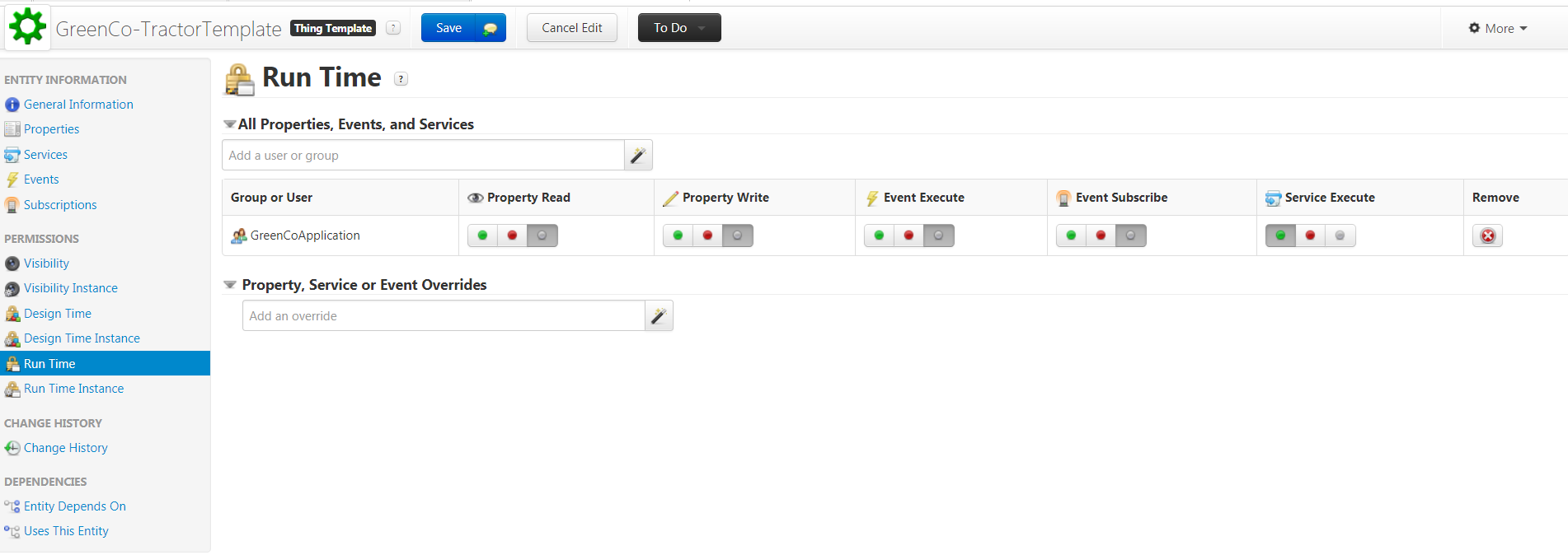

Hi Satoshi, Click on your desired Thingtemplate or thing and select Run Time link in the explorer. Now in (All Properties, Events, and services )-->type the group or user you want to set the permissions.  Select the green dot to allow and red dot to deny.  You can also set permissions to individual properties in (property,Service or Event Overrides). Let me know if this doesn't solve your problem .
