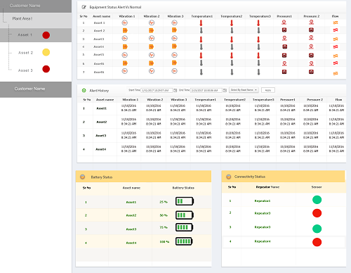

    My first page
    On clicking left side any asset it goes to second page.

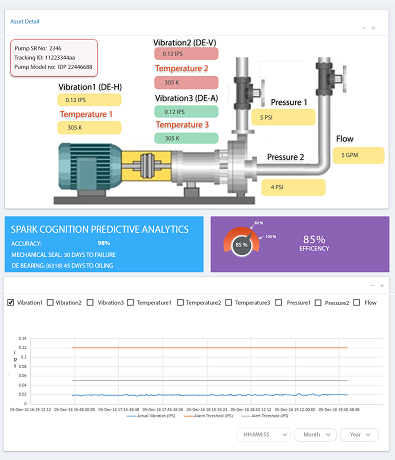

    My second Page

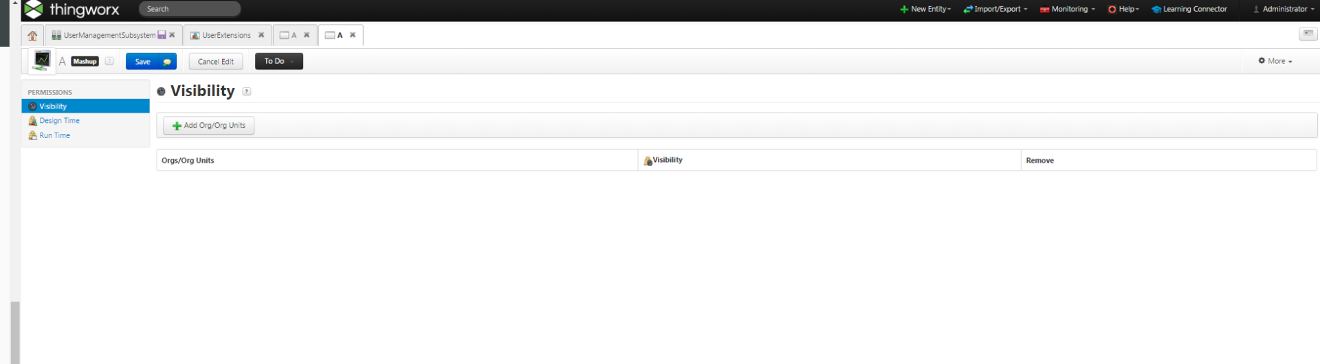

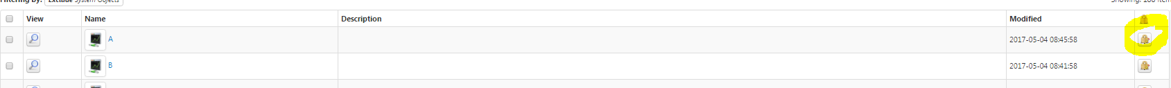

    Go to your mashup list in the composer and click this icon across the mashup page you need to restrict:
    Then
    Then you may specify permissions on the runtime.
    Alternatively, you can get rid of the Everyone organization and set up your permissions group by group for everything, including visibility. That way by default  nobody would have a permission to view your mashups and instead you would set up visibility for each group individually.

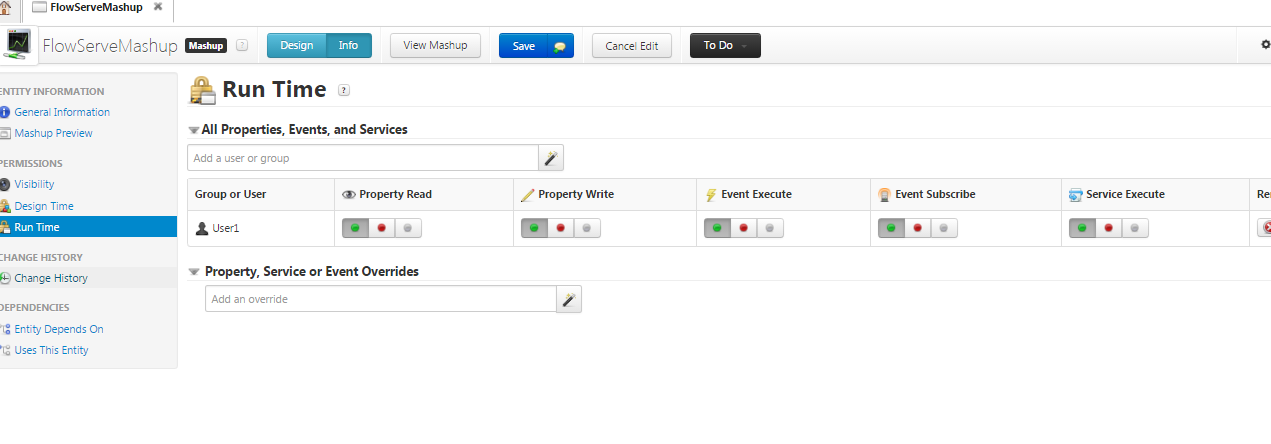

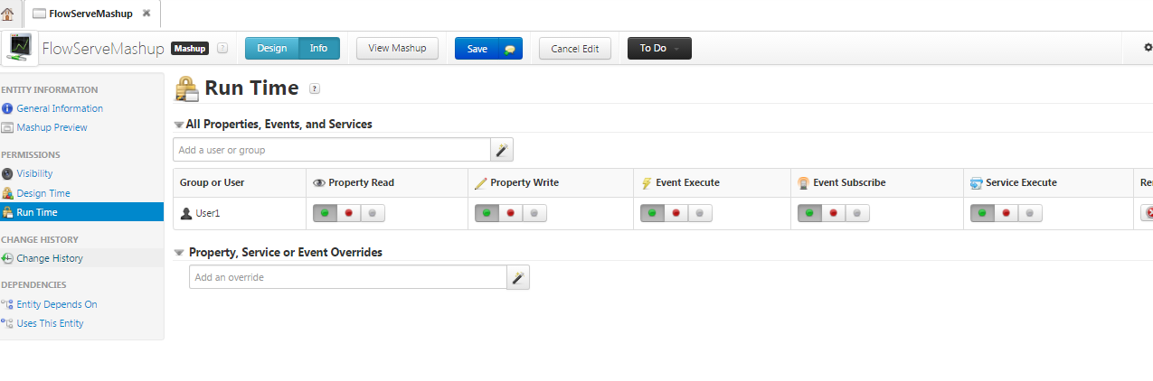

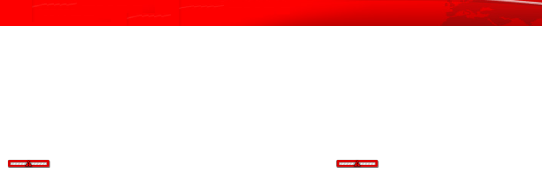

    Now I have created one user : User1.
    For this user I have given following Design and Run time permission for my FlowserveMashup.

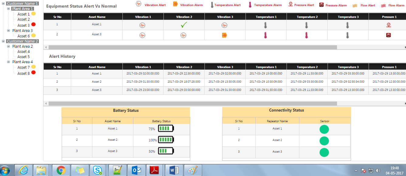

    When I am viewing  as User1 user FlowserveMashup I am seeing something like below
    But when as administrator i am viewing FlowserveMashup lokk like
    Can you let me know what is problem? Is any other access require to see  mashup seems to look administrator user?
    20-Turquoise
    May 4, 2017
    You would need to set up permissions on every thing, thing template, service, persistence provider(storage) used in the mashup. You may try collection level permissions - the lock icon next to the collection name (Things, Thing Templates, etc)
