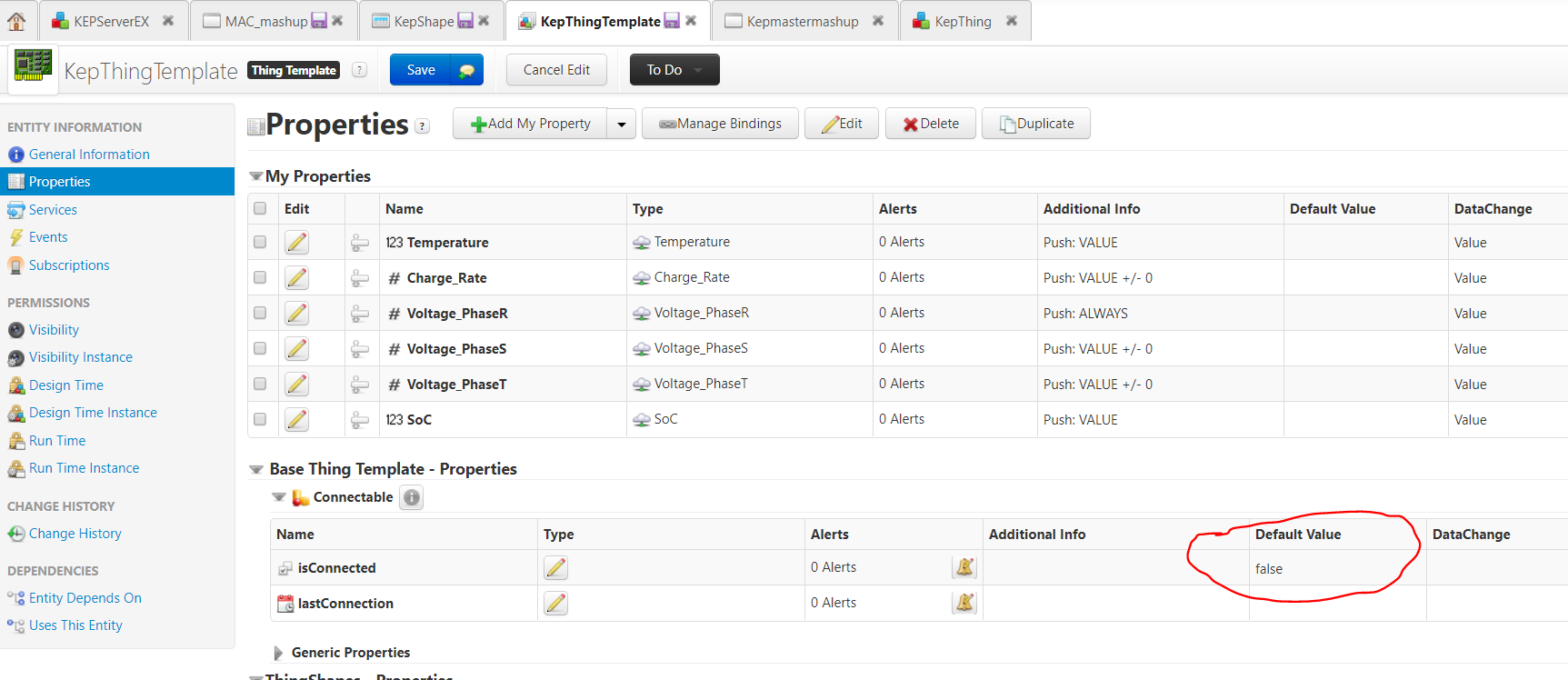

  • Using a template create from a thing and calling to "GetimplementedthingswithData" service, this doesn't work for me:
    • I created my Industrial Connection (KEPServerEX) and industrial thing (KEPThing) in New Composer, as explained in the Help Center. Now I have created a template from the KEPThing, but this template is not connected so I cannot get data from Kepware despite it has inherited the KEPThing properties. In the mashup, I can call the "GetimplementedthingswithData" service and bind the data to the time series chart but, as the template is disconnected, there is no values displayed.

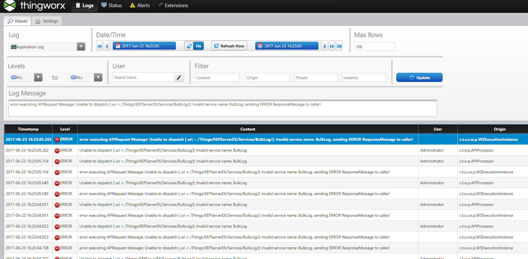

If helps, this is the event log window:

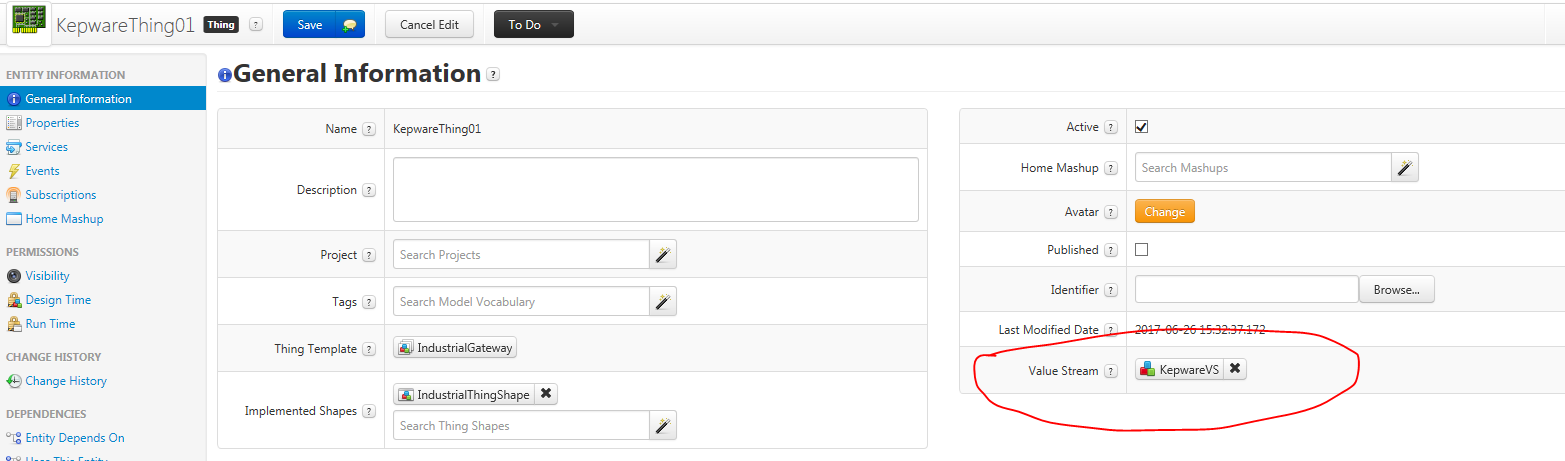

Youc could consider to use Value Stream to store your data.
After you successfully discovered Tags in your KEPServerEX Thing, You browse the Tags in Kepware from KEPServerEX Thing, and then you bind it to a New Thing with "Bind to New Entity", and this new Entity is based on IndustrialGateway Template, and also remember to set a Value Stream:
Set the bound Tags which you want to show in mashup with "Logged".
And then you bind QueryPropertyHistory in the new kepware Thing in your mashup, and bind the Returned Data to Time Series Chart. To get refreshed periodically, you could add a Auto Refresh widget in your mashup.

1. Assign Value Stream to your Kepware Template and enable logging for properties to be displayed in Chart.
2. Add "QueryPropertyHistroy" service in Mashup for your "THING" and map "AllData" to your Chart Widget.
