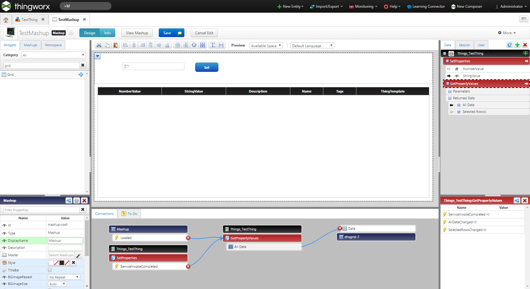

I want use my mashup to write a property value ,and i can show it with grid and some other property.How an i do it

I guess you want to set a value for a property and display a result in a Grid widget with other properties, right?
If so, you can use the "SetProperties" service for the thing to set values and the "GetPropertiesValues" service to get values and display in a grid.

yes,i want do this,but i cant find the set button
June 22, 2017
The "Set" button is just a button widget, but I set the label for it.

Hi wenjie fan​,
Please refer to my example.
