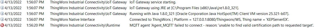

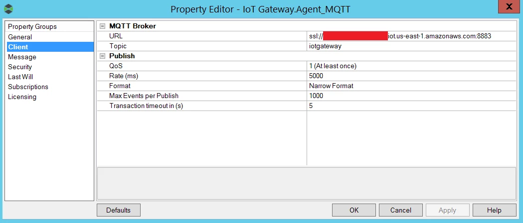

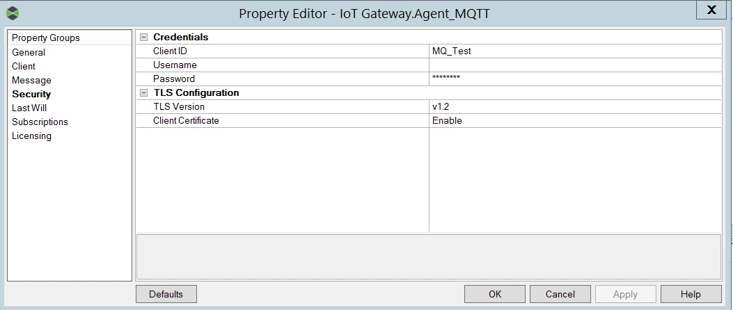

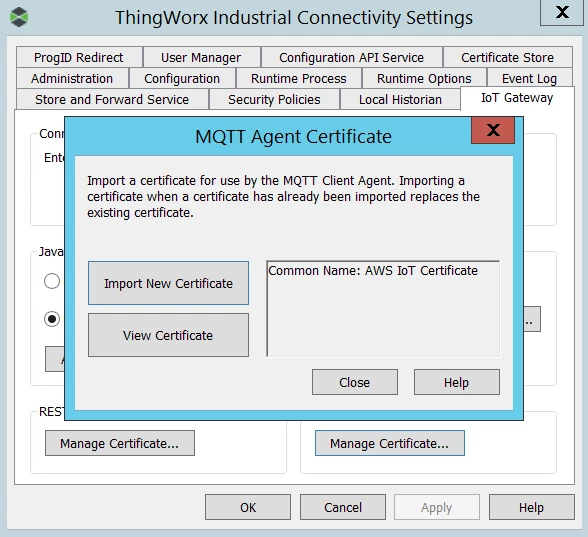

But I'm having a new problem, after I follow all the steps to set it up
1. Create Thing in AWS,
2. Download and activate certificate, attach a policy in AWS Thing,
3. Import certificate in Kepware IoT Gateway setting page,
4. Create a new IoT Gateway agent, set the URL address and TLS Configuration,
5. Reinitialize Kepware.
And the following error message appears in kerpware, "MQTT agent 'Agent Name' failed to connect - reason: 'unable to find valid certification path to requested target'." (as shown in the attached image).
How can I solve this problem.
The version of kepware I am using is KEPServerEX 6.5 / ThingWorx Industrial Connectivity 8.3.65.
Best Regards
Bill
April 13, 2022
Hello @Bill_Wang ,
After analyzing the attached errors, it seems like certificate issue. pls check the given article link and post:
https://www.ptc.com/en/support/article/CS307827
https://community.ptc.com/t5/ThingWorx-Developers/How-to-solve-SSLHandshakeException/td-p/514206
Also I would recommend you to open the case with PTC support.
Regards
