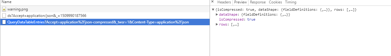

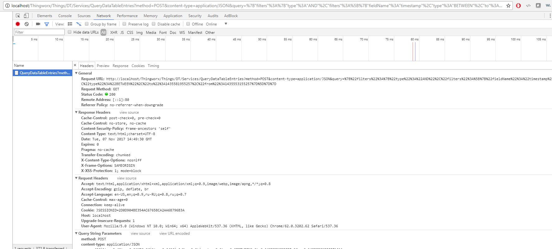

You may also find helpful to utilize your browser dev tools in which you can see the structure of every request (f12 in chrome)

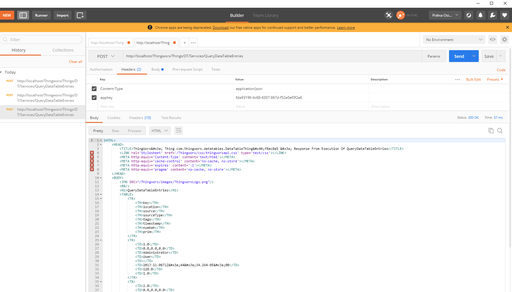

In addition, you may use Postman:
