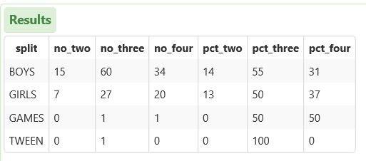

How to achieve excel like pivot functionality in Thingworx?
Tried using Pivot function, but it has limited functionality with dependency on timestamp property. So cannot achieve excel like pivot capability. Are there any other ways/options to achieve the same in ThingWorx?

August 30, 2017
Not as far as I know. But you may cook data to convert non timestamp fields to timestamp field:
Category = A = new Date(0)
Category = B = new Date(1)
abhide-410-MarbleAuthorAnswer
August 31, 2017
Below is a sample working code as a reference for anyone looking to generate excel like pivot table successfully in Thingworx.

            newEntry.pct_four = Math.round(100 * newEntry.no_four/(newEntry.no_two + newEntry.no_three + newEntry.no_four)); // NUMBER
         //Add this entire row to the result infoTable
         result.AddRow(newEntry);
