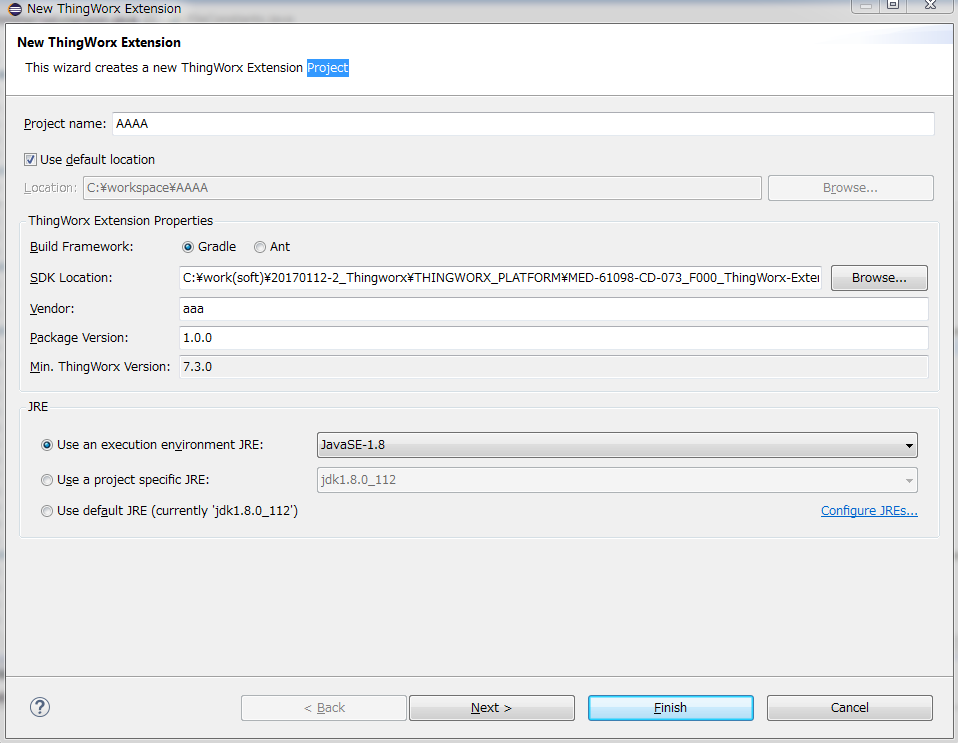

I want to make a Extension Package with java . and  how to add the Description of the Project.
there no place to do it.
is it possible to do it? how to do?

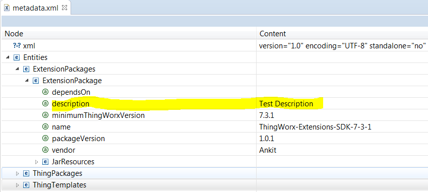

Hi wlihua​,
In your eclipse project navigate to PackageExplorer -> <YourThingWorxExtensionProject> -> configfiles -> metadata.xml
and update the description field highlighted below and save.
I hope it helps.

Hi wlihua​,
I hope it helps.
